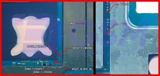

بسم الله الرحمن الرحيم
Samsung SM-A165F (Galaxy A16) Erase FRP By ISP
تجربة ناجحة
مستوى الحماية على Bootloader (B=11) آخر حماية لتاريخ كتابة هذا الموضوع
بيانات العملية:
Model Settings:
Interface : UFS
Gear      : PWM Gear 1
Connecting to server. Please wait...
Connection to server successful
Pin connector is detected!(eMMC: 1b, UFS: PWM 1-4)
Connecting UFS  in ISP  gear 1 wait ...Check device ...
Voltages 3.14V;1.19V;1.78V
 Please use USB3.0 for better speed.
Connected. Reading information.
Support for security LU: RPMB

Backuping efs partition from start 00000400, size 00000800 ...
Opening C:/Program Files (x86)/Medusa Pro Software/Backups/SAMSUNG_KM5L9000CM-B424_efs_0x400_0x800_27_10_2026_12_08_04.bin file...
Reading. Please wait...Done.
Elapsed time 00:00:13
SW: 2.2.5.8; FW: 1.00.
Backuping nvdata partition from start 00011800, size 00004000 ...
Opening C:/Program Files (x86)/Medusa Pro Software/Backups/SAMSUNG_KM5L9000CM-B424_nvdata_0x11800_0x4000_27_10_2026_12_08_04.bin file...
Elapsed time 00:01:49
Searching Android build info...
Build ID              : BP4A.251205.006
Display Build ID      : BP4A.251205.006.A165FXXSBDZH6
Release ID            : 16
Architecture ABI      : arm64-v8a
Architecture ABI List : arm64-v8a,armeabi-v7a,armeabi
Build Description     : a16nsxx-user 16 BP4A.251205.006 A165FXXSBDZH6 release-keys
Writing /system/build.prop file
 C:/Program Files (x86)/Medusa Pro Software/Logs/BUILD_PROP_SAMSUNG_KM5L9000CM-B424_27_10_2026_12_10_09.txt
RPMB: Counter of the successful data write requests = 3335.
LUN 0 info:
Found WP Area at Lun 0 with WPT - NV-type: WPF bit is persistent through power cycle and hardware reset.WPFlag value may only be changed writing to Secure Write ProtectConfiguration Block. and WPF - Secure Write Protection is disabled. start: 0x0 and size: 0x0(Lun: 0; WPT: 0; WPF: 0; start: 0x0; size: 0x0)
LUN 1 info:
Found WP Area at Lun 1 with WPT - NV-type: WPF bit is persistent through power cycle and hardware reset.WPFlag value may only be changed writing to Secure Write ProtectConfiguration Block. and WPF - Secure Write Protection is disabled. start: 0x0 and size: 0x0(Lun: 1; WPT: 0; WPF: 0; start: 0x0; size: 0x0)
LUN 2 info:
Found WP Area at Lun 2 with WPT - NV-type: WPF bit is persistent through power cycle and hardware reset.WPFlag value may only be changed writing to Secure Write ProtectConfiguration Block. and WPF - Secure Write Protection is disabled. start: 0x0 and size: 0x0(Lun: 2; WPT: 0; WPF: 0; start: 0x0; size: 0x0)
Partition table has been found on device.
Don't forget to reconnect the device after writing to see changes.
Writting partitions. Please wait...
Physical partition number: 2
Writing partition misc from E:/ISP JTAG/Repair by UFS/SAMSUNG/SM-A165F SM-A165M/misc_512k_zero.bin file...    Done.
Writing partition frp from E:/ISP JTAG/Repair by UFS/SAMSUNG/SM-A165F SM-A165M/frp_1MB_zero.bin file...    Done.
Writing partition persistent from E:/ISP JTAG/Repair by UFS/SAMSUNG/SM-A165F SM-A165M/persistent_512k_zero.bin file...    Done.
Writing is finished.
