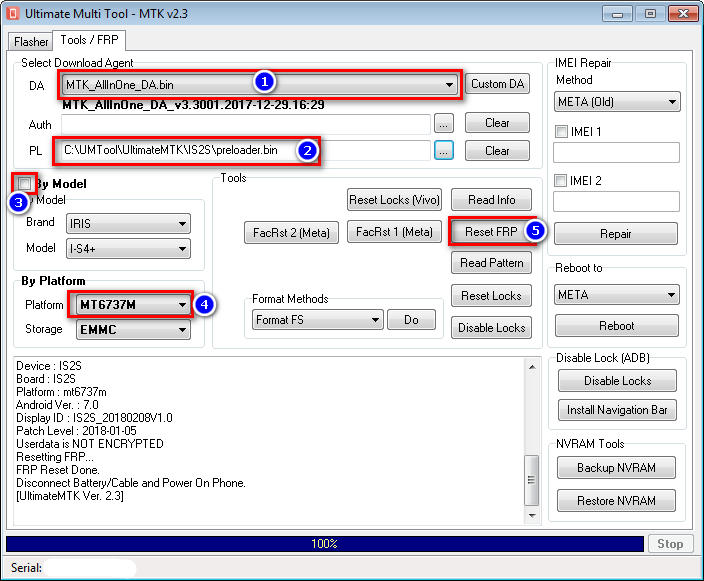

FRP Reset Tablettes Condor TGW801L
Operation : Reset FRP
CPU : MT6735M
Storage : EMMC
DA : MTK_AllInOne_DA.bin [MTK_AllInOne_DA_v3.3001.2017-12-29.16:29]
Waiting for Phone in BROM Mode...
Connect Power Off phone within 30 secs...
Port : MediaTek PreLoader USB VCOM (Android) (COM4)
Connected to BROM.
Sending Download Agent...
connect DA end stage: 2, enable DRAM in 1st DA: 0
Connected to Download Agent..
Syncing with Target...
Reading Partition Table...
Reading Device Information...
Brand : alps
Manufacturer : alps
Model : elink8735m_3tb_l
Prod. Name : full_elink8735m_3tb_l
Device : elink8735m_3tb_l
Platform : mt6735m
Android Ver. : 5.1
Display ID : TGW801L_MTK8735_1G_8G_V1.0.0_20170105
Patch Level : 2016-05-01
Userdata is NOT ENCRYPTED
Resetting FRP...
FRP Reset Done.
Disconnect Battery/Cable and Power On Phone.
[UltimateMTK Ver. 2.7]
