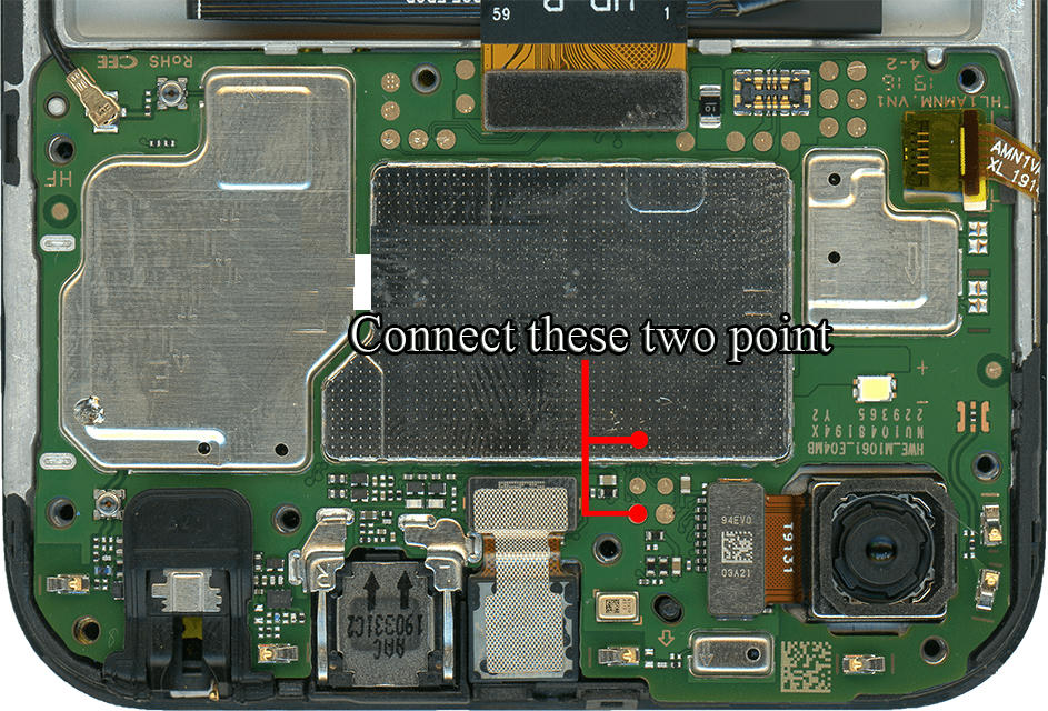

ازالة حساب جوجل لجهاز Huawei Honor 8S KSA-LX9 9.1.0.382 بالتيست بوينت
4,654
8,313
1. Power off device2. Remove Install battery if needed
3. Connect USB cable to powered off device
4. For New sec. Press and Hold Both Volume keys for Brom Mode
5. For Old sec. Press and Hold Volume UP for Brom Mode
6. Do not press any Key for PreLoader Mode
7. Install drivers if needed
- Connection : Flash Mode
- Method : By Model
- Brand : Huawei
- Model : KSA-LX9 (Honor 8S)
- Process : Reset FRP

Getting partition details : DONE
Partition count : 47
Searching FRP data...  DONE
Resetting FRP...
USING ALGO - 1
Reset FRP DONE
Please disconnect device and reboot it manually
