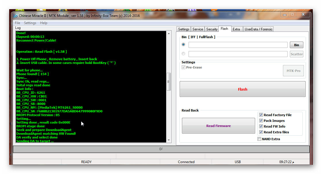

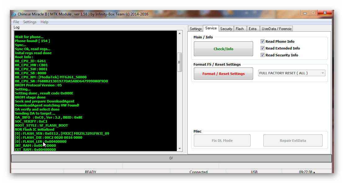

========================= Start =========================
09/05/2021 / 09:18:52 م
Card found : S/N : 41DEDF35 , v0147
Chinese Miracle II [MTK module] v 1.58
Start at : [09/05/2021 / 09:19:17 م]
Operation : Check / Read Info [ v1.58 ]
2. Insert USB cable. In some cases require hold BootKey ( '*' )
Wait for phone...
Device boot not done
Check Drivers
Try again
Boot Error!
Operation Failed
Elapsed: 00:00:55
Reconnect Power/Cable!
Finish at : [09/05/2021 / 09:20:12 م]
09/05/2021 / 09:20:56 م
09/05/2021 / 09:21:34 م
Start at : [09/05/2021 / 09:22:03 م]
Wait for phone...
Phone found! [ 154 ]
Sync...
Sync Ok, read regs...
Initial Register Read Failed (HW/Connection Error)
Boot Error!
Operation Failed
Elapsed: 00:00:55
Finish at : [09/05/2021 / 09:22:59 م]
Start at : [09/05/2021 / 09:23:03 م]
Wait for phone...
Sync...
Inital regs read done
Boot Info :
BB_CPU_ID : 6261
BB_CPU_HW : CB01
BB_CPU_SW : 0001
BB_CPU_SB : 8000
BB_CPU_NM : [MediaTek] MT6261_S0000
BB_CPU_SN : F688B21301977DA5ABD647999080F9D0
BROM Protocol Version : 05
Setting...
Setting done , result code 0x000E
BROM stage done
Seek and prepare DownloadAgent
DownloadAgent matching HW Found!
DA verify and select done
Sending DA to target ...
DA_INFO : 0xC0 , Ver : 3.2 , BBID : 0x8E
SOC_VERIFY : 0xC1
BOOT_STYLE : SF_FLASH_BOOT
NOR Flash IC initialized
[0] : FLASH_VEN : 0x0112 , [MXIC] MX25L3291FWJI_09
[0] : FLASH_DIE : 00C2 0020 0016 0000
[0] : FLASH_LEN : 0x00400000
INT_RAM : 0x0000D000
EXT_RAM : 0x00400000
File_Info : J106_5_61D_11C_128X160_PCB01_gprs_MT6261_S00.J016_05_11C_W13_52_MP_V10.bin
FileVersion : J016.05.11C.W13.52.MP.V10
Done!
Elapsed: 00:00:13
Finish at : [09/05/2021 / 09:23:17 م]
Start at : [09/05/2021 / 09:23:46 م]
Operation : Read Flash [ v1.58 ]
Wait for phone...
Sync...
Boot Info :
BB_CPU_ID : 6261
BB_CPU_HW : CB01
BB_CPU_SW : 0001
BB_CPU_SB : 8000
Setting...
BROM stage done
SOC_VERIFY : 0xC1
Reading Flash Content now ...
Read Flash now
Read Ok , 4194304 bytes read
Check and collect compile info
[ScatCFG] : MT6261 / J016.05.11C.W13.52.MP.V10 / NOR , SF
Firmware saved to : D:\BST\infinty\CM2MTK\Read_out\J106_5_61D_11C_128X160_PCB01_gprs_MT6261_S00\
Done!
Elapsed: 00:00:16
Finish at : [09/05/2021 / 09:24:02 م]
Start at : [09/05/2021 / 09:24:14 م]
Operation : Read UserCode [ v1.58 ]
Wait for phone...
Sync...
Boot Info :
BB_CPU_ID : 6261
BB_CPU_HW : CB01
BB_CPU_SW : 0001
BB_CPU_SB : 8000
Setting...
BROM stage done
SOC_VERIFY : 0xC1
Read ExtData
Sorting ExtData
Reading UserCode
Active : Yes , Code : 11110
PLock|MobTrack : Not active
Done!
Elapsed: 00:00:09
Finish at : [09/05/2021 / 09:24:23 م]
