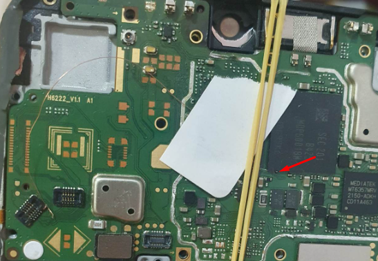

تفليش الجهاز Infinix Hot 12I (X665B) المعلق على الشعار بالتيست بوينت
sss
Waiting For Device Connection...
USB PORT: MediaTek USB Port (COM9)
Port: MediaTek USB Port (COM9)
Manufacturer: MediaTek Inc.
OPEN COM PORT... OK
Handshake... OK
Waiting for server........ OK
Read CHIP ID... OK
HW-CODE: 0X717
CPU: MT6761
Read Chip Version... OK
HW-SUBCODE: 0X8A00
HW-VERSION: 0XCA01
SW-VERSION: 0X0200
Read Phone Configuration... OK
Bypass Security Protection... OK
Send Protection Files BROM... OK
Check BROM status... OK
Setup DEVICE... OK
Init HARDWARE... OK
Setup DEVICE... OK
Read DEVICE Status... BROM
Load emi config from preloader... OK
Init EXT RAM... OK
Send Download Agent... OK
Read Device Info... OK
EMMC INFO:
EMMC Boot1 Size: 4.00 MB
EMMC Boot2 Size: 4.00 MB
EMMC RPMB Size: 16.00 MB
EMMC USER Size: 58.24 GB
EMMC CID: 15010044503644424202B77DF258B8BD
RAM INFO:
SRAM Size: 228.00 KB
DRAM Size: 4.00 GB
CHANGE TO HIGH-SPEED PORT... OK
Read Partition Table...
Server ... OK
Get Partition ... OK
Read Build Prop Info... OK
Brand: INFINIX
Product: TSSI
Manufacturer: INFINIX MOBILITY LIMITED
Android Version: 11 (Android 11)
Security Patch: 2023-05-05
Build ID: RP1A.200720.011
Build Date: MON JUN 19 19:18:56 CST 2023
Display ID: X665B-H6222IJKL-R-OP-230619V694
Build: 230619V416
Read Internal Storage Info... OK
USERDATA: 51.04 GB
USERDATA: ENCRYPTED
Reboot... OK
Elapsed Time: 50 secs, 689 msecs
