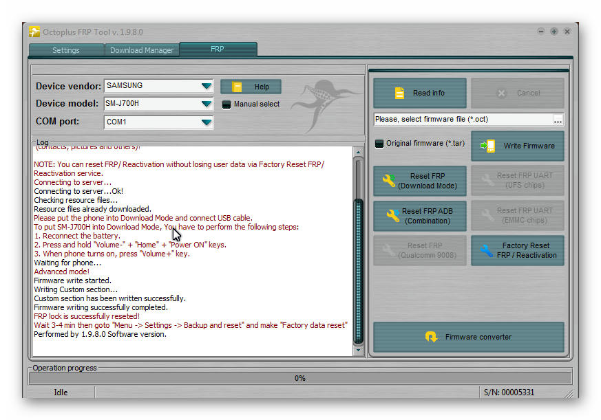

ازالة قفل FRP لهاتف Samsung Galaxy J7 3G SM-J700H 6.0.1 S3
Welcome to Octoplus FRP Tool v.1.9.8.0
Card S/N: 00005331
Work ID: 0000000000489782
Platform: SAMSUNG
Selected model: SM-J700H
Reset FRP/ Reactivation lock operation for SM-J700H will delete all user data on the phone (contacts, pictures and others)!
NOTE: You can reset FRP/ Reactivation without losing user data via Factory Reset FRP/ Reactivation service.
Connecting to server...
Connecting to server...Ok!
Checking resource files...
Resource files already downloaded.
Please put the phone into Download Mode and connect USB cable.
To put SM-J700H into Download Mode, You have to perform the following steps:
1. Reconnect the battery.
2. Press and hold "Volume-" + "Home" + "Power ON" keys.
3. When phone turns on, press "Volume+" key.
Waiting for phone...
Advanced mode!
Firmware write started.
Writing Custom section...
Custom section has been written successfully.
Firmware writing successfully completed.
FRP lock is successfully reseted!
Wait 3-4 min then goto "Menu -> Settings -> Backup and reset" and make "Factory data reset"
Performed by 1.9.8.0 Software version.

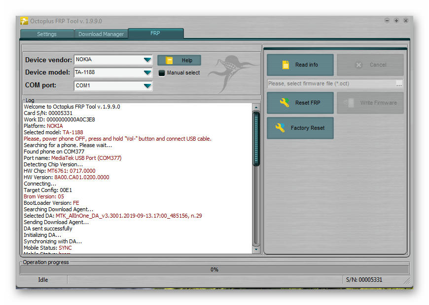

ازالة قفل FRP لهاتف Nokia 2.2 TA-1188
Welcome to Octoplus FRP Tool v.1.9.9.0
Card S/N: 00005331
Work ID: 0000000000A0C3E8
Platform: NOKIA
Selected model: TA-1188
Please, power phone OFF, press and hold "Vol-" button and connect USB cable.
Searching for a phone. Please wait...
Found phone on COM377
Port name: MediaTek USB Port (COM377)
Detecting Chip Version...
HW Chip: MT6761: 0717.0000
HW Version: 8A00.CA01.0200.0000
Connecting...
Target Config: 00E1
Brom Version: 05
BootLoader Version: FE
Searching Download Agent...
Selected DA: MTK_AllInOne_DA_v3.3001.2019-09-13.17:00_485156, n.29
Sending Download Agent...
DA sent successfully
Initializing DA...
Synchronizing with DA...
Mobile Status: SYNC
Mobile Status: brom
Sending BootLoader Info...
Initializing Memory Flash..
Initialization successfully completed
Sending loaders...
Mobile Status: SYNC
Reading Flash Info...
EMMC rpmb size: 4 Mb
EMMC boot1 size: 4 Mb
EMMC boot2 size: 4 Mb
EMMC gp1 size: 0 Mb
EMMC gp2 size: 0 Mb
EMMC gp3 size: 0 Mb
EMMC gp4 size: 0 Mb
EMMC user area size: 14976 Mb
eMMC Flash: .70010054.42323831.36201AE9.3C174635
eMMC Flash: Pretec: TB2816
Internal RAM size: 228 Kb
External RAM size: 2048 Mb
Reading partition...
Reading info...
Brand: Nokia
Manufacturer: HMD Global
Model: Nokia 2.2
Device: WSP_sprout
Android version: 10
Display ID: 00WW_2_400
Searching for signatures...
Resetting FRP lock..
Backup saved as Nokia_Nokia 2.2_23-02-2021_17-24-52.dump file
Performed by 1.9.9.0 Software version.

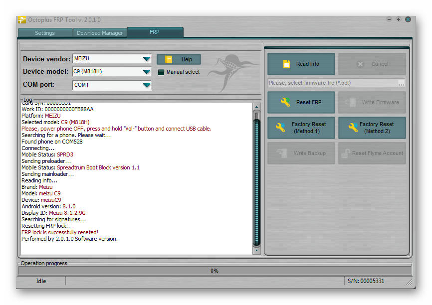

ازالة قفل FRP لجهاز Meizu C9 M818H
Welcome to Octoplus FRP Tool v.2.0.1.0
Card S/N: 00005331
Work ID: 0000000000FB88AA
Platform: MEIZU
Selected model: C9 (M818H)
Found phone on COM528
Connecting...
Mobile Status: SPRD3
Sending preloader...
Mobile Status: Spreadtrum Boot Block version 1.1
Sending mainloader...
Reading info...
Brand: Meizu
Model: meizu C9
Device: meizuC9
Android version: 8.1.0
Display ID: Meizu 8.1.2.9G
Performed by 2.0.1.0 Software version.
