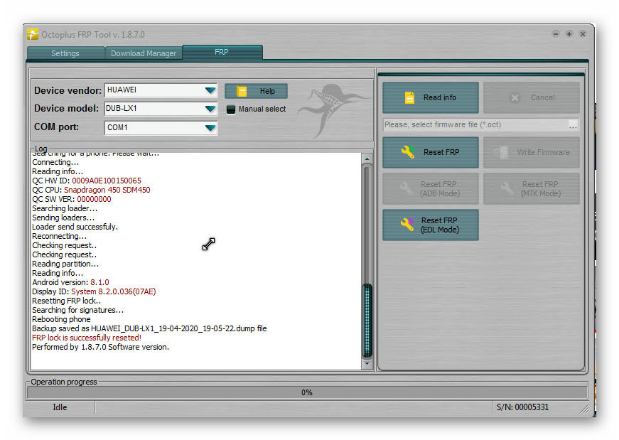

ازالة قفل FRP لهاتف Huawei Y7 Prime 2019 DUB-LX1 بالتيست بوينت الحمايه 8.2.0.155
اصدار الهاتف
DUB-LX1 8.2.0.155(C185)
Welcome to Octoplus FRP Tool v.1.8.7.0Platform: HUAWEI
Selected model: DUB-LX1
Put the phone into EDL mode:
1. Attach testpoint as shown in Help manual;
2. Connect USB cable;
3. Release testpoint after 3-5 seconds.
Searching for a phone. Please wait...
Operation was failed!
Performed by 1.8.7.0 Software version.
Platform: HUAWEI
Platform: HUAWEI
Platform: HUAWEI
Connecting...
Reading info...
QC HW ID: 0009A0E100150065
QC CPU: Snapdragon 450 SDM450
QC SW VER: 00000000
Searching loader...
Sending loaders...
Loader send successfuly.
Reconnecting...
Checking request..
Checking request..
Reading partition...
Reading info...
Android version: 8.1.0
Display ID: System 8.2.0.036(07AE)
Resetting FRP lock..
Searching for signatures...
Rebooting phone
Backup saved as HUAWEI_DUB-LX1_19-04-2020_19-05-22.dump file
FRP lock is successfully reseted!
