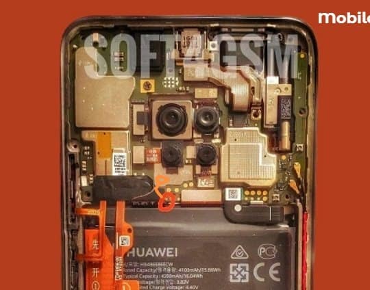

- Power device Off [remember Test-Point]
- Connect cable [remember Vol+ | Vol-]
