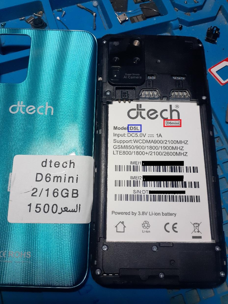

السلام عليكم و رحمة الله تعالى و بركاته
(نواصل مع الحصريات)
تم بحمد الله سحب فلاشةD-Tech D 6 mini موديل D5L على العملاق InfinityBox CM2SP2

بيانات سحب الفلاشة
Operation : Read FW [ v2.14 ]
1. Power off device, wait 10-15 seconds
2. Press and hold BooKey ( 1 : BOTH VOL , 2 : VOL+ , 3 : VOL- )
3. Insert cable in device!
Wait for device ...
Device Connected!
BootVersion : SPRD3
[COLOR="#FFFF00"][COLOR="#FF0000"]Boot[/COLOR][/COLOR] : INF : [COLOR="#008000"]0_SC9832E_BASE : SC9832E_eMMC_1GB_RS[/COLOR]
Sending Init Boot ...
Boot sent!
Kick FDL ...
BootVersion : Spreadtrum Boot Block version 1.1
Protocol setup ...
Port speed : 921600
Sending Flash Boot ...
Boot sent!
Kick FLASH FDL ...
FDL : 0x0002
FDL : Control transfered!
Boot Done!
Device info :
Product Brand  : D-Tech
Product Device : D5L
Product Model  :[SIZE=5] [COLOR="#0000FF"]D5L[/COLOR][/SIZE]
Product Name   : D5L
Patch Level    : RP1A.201005.001
Display ID     :[COLOR="#0000FF"][SIZE=4] J106E_9832E_D-Tech_V001_20211214[/SIZE][/COLOR]
Ver. Incmt     : 50122
Ver. CodeName  : REL
Ver. Release   : 11
Sec. Patch     : 2021-11-05
Build Time     : 13.12.2021
Product Info   : D5L
Product Board  : sp9832e_1h10_go
Board Platform : sp9832e
Product Manfct : HOTWAV
AndroidVer : 11
VlnrLevel : 0x02
[COLOR="#0000FF"][SIZE=5]SP9832E__11__J106E_9832E_D-Tech_V001_20211214__RP1A.201005.001__D5L[/SIZE][/COLOR]
Read : u-boot.bin
Make : persist.img
Make : userdata.img
Read : prodnv.img
Read : phase.cfg
Read : super.img
Read : u-boot-spl.bin
Firmware size : 0x8FEE6B38 ([COLOR="#0000FF"] 2,25 GiB[/COLOR] )
Android Info saved : _Android_info.txt
Reconnect Power/Cable!
