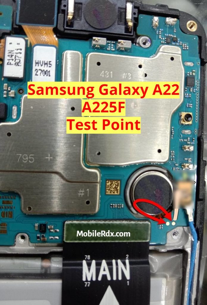

ازالة قفل frp ل Samsung Galaxy A02 SM-A022F بالتيست بوينت الحمايه u2
4,652
8,313
Operation : MTK One Click
[FONT=Almarai]Hold VOL UP + DOWN and connect USB Cable.[/FONT]
[FONT=Almarai]Some phone may have different key combination for BROM mode.[/FONT]
[FONT=Almarai]Waiting for device in BROM mode...[/FONT]
[FONT=Almarai]Port: COM5 [MediaTek USB Port_V1632 (COM5)][/FONT]
[FONT=Almarai]Device Path: \\?\usb#vid_0e8d&pid_0003#7&2d60df3f&0&4#{86e0d1e0-8089-11d0-9ce4-08003e301f73}[/FONT]
[FONT=Almarai]Chipset: 0x0699, [MT6739/MT6731] [Unknown][/FONT]
[FONT=Almarai]Hardware Info: 0x8A00, 0xCB00, 0x02[/FONT]
[FONT=Almarai]Config : [SecureBoot: True] [SLA: False] [DA Auth: True][/FONT]
[FONT=Almarai]MEID: F3534BBDEA402A0AD7B19AA4497AE8E1[/FONT]
[FONT=Almarai]Preparing device...[/FONT]
[FONT=Almarai]-- Success![/FONT]
[FONT=Almarai]Preloader saved as : preloader_k39tv1_bsp_titan_hamster_211217_190351.bin[/FONT]
[FONT=Almarai]DA : MTK_AllInOne_DA.bin[/FONT]
[FONT=Almarai]Waiting for Phone in Flash Mode...[/FONT]
[FONT=Almarai]Connect Power Off phone within 30 secs...[/FONT]
[FONT=Almarai]Port : MediaTek USB Port_V1632 (COM5)[/FONT]
[FONT=Almarai]Connected to BROM.[/FONT]
[FONT=Almarai]Sending Download Agent...[/FONT]
[FONT=Almarai]connect DA end stage: 2, enable DRAM in 1st DA: 0[/FONT]
[FONT=Almarai]Connected to Download Agent..[/FONT]
[FONT=Almarai]Syncing with Target...[/FONT]
[FONT=Almarai]Reading Partition Table...[/FONT]
[FONT=Almarai]Storage : eMMC[/FONT]
[FONT=Almarai]Reading Information...[/FONT]
[FONT=Almarai]Build Date : Tue Sep 28 20:42:38 +07 2021[/FONT]
[FONT=Almarai]Build Flavor : a02xx-user[/FONT]
[FONT=Almarai]Build Desc. : a02xx-user 11 RP1A.200720.012 A022FXXU2BUI6 release-keys[/FONT]
[FONT=Almarai]Android Ver. : 11[/FONT]
[FONT=Almarai]Display ID : RP1A.200720.012.A022FXXU2BUI6[/FONT]
[FONT=Almarai]Patch Level : 2021-09-01[/FONT]
[FONT=Almarai]Userdata is ENCRYPTED[/FONT]
[FONT=Almarai]Seeking FRP Data...[/FONT]
[FONT=Almarai]Resetting FRP...[/FONT]
[FONT=Almarai]- Success![/FONT]
[FONT=Almarai]- Resetting FRP[2]...[/FONT]
[FONT=Almarai]- Failed![/FONT]
[FONT=Almarai]Disconnect Battery/Cable and Power On Phone.[/FONT]
[FONT=Almarai][UltimateMTK Ver. 4.7][/FONT]
