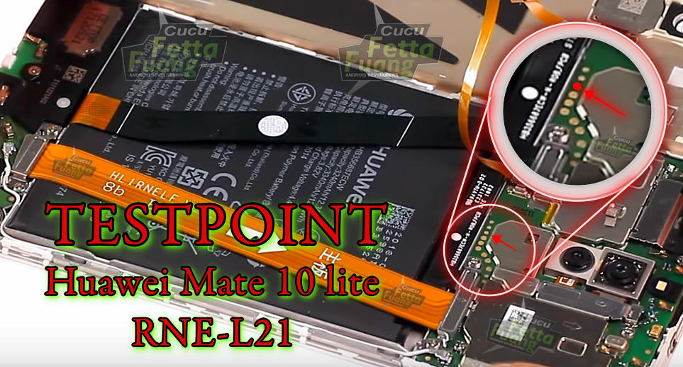

ازالة قفل FRP لجهاز Huawei Mate 10 lite RNE-L21 بالتيست بوينت حماية 8.0.0.3488

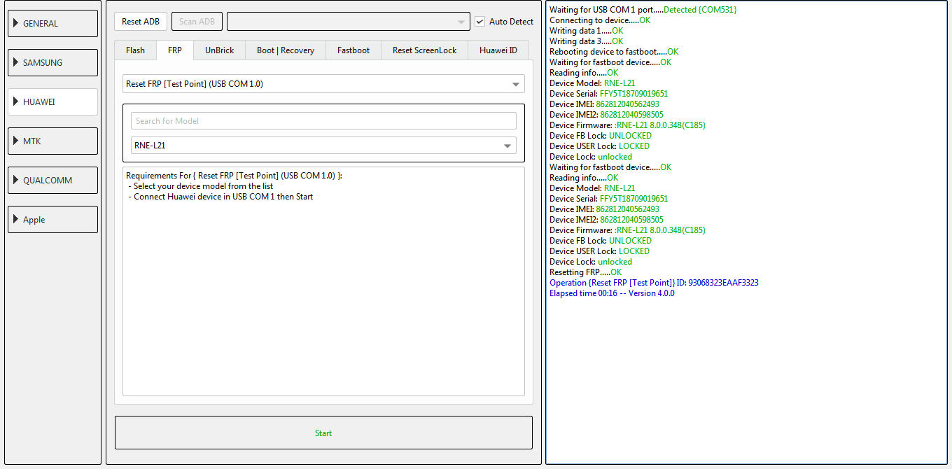

Reading info.....OK
Device Model: RNE-L21
Device Serial: FFY5T18709019651
Device IMEI: 862812040562493
Device IMEI2: 862812040598505
Device Firmware: :RNE-L21 8.0.0.348(C185)
Preload Firmware: :
Device FB Lock: LOCKED
Device USER Lock: LOCKED
Device Lock: locked
Operation {Read info} ID: E64B28CD8F512B7A
Elapsed time 00:03 -- Version 4.0.0
Waiting for USB COM 1 port.....Detected {COM531}
Connecting to device.....OK
Writing data 1.....OK
Writing data 3.....OK
Reboo
ting device to fastboot.....OK
Waiting for fastboot device.....OK
Reading info.....OK
Device FB Lock: UNLOCKED
Device Lock: unlocked
Reading info.....OK
Resetting FRP.....OK
Operation {Reset FRP [Test Point]} ID: 93068323EAAF3323
Elapsed time 00:16 -- Version 4.0.0
