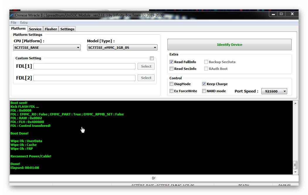

ازالة قفل FRP لجهاز Tecno Pop 4 معالج SC7731E SPD
4,424
8,106
والجهاز مقفل اظغط خفض الصوت ووصل كيبل USB
Operation : Identify [ v2.11 ]
BootMode : FLASH
1. Power off device, wait 10-15 seconds
2. Press and hold BooKey ( 1 : BOTH VOL , 2 : VOL+ , 3 : VOL- )
3. Insert cable in device!
Wait for device ...
Device Connected!
BootVersion : SPRD3
Boot : INF : 0_SC7731E_BASE : SC7731E_eMMC_1GB_0S
Sending Init Boot ...
Boot sent!
Kick FDL ...
BootVersion : Spreadtrum Boot Block version 1.1
Protocol setup ...
Port speed : 921600
Sending Flash Boot ...
Boot sent!
Kick FLASH FDL ...
FDL : 0x0008
FDL : EMMC_RO : False ; EMMC_PART : True ; EMMC_RPMB_SET : False
FDL : RAW : 0x0002
FDL : FLH : 0x400000
FDL : Control transfered!
Boot Done!
Device info :
Product Brand : TECNO
Product Name : BC2c-OP
Product Device : TECNO-BC2c
Product Model : TECNO BC2c
Product Board : BC2c
Patch Level : QP1A.190711.020
Display ID : BC2c-SP592AB-QGo-OP-210306V008
Ver. Incmt : AB-OP-210306V008
Ver. CodeName : REL
Ver. Release : 10
Sec. Patch : 2021-03-05
Build Time : 11.03.2021
Product Info : sp7731e_1h10
Product Board : sp7731e_1h10
Board Platform : sp7731e
Product Manfct : TECNO
Product Manfct : TECNO MOBILE LIMITED
USERDATA : FILESYSTEM : F2FS with FDE ( Full Disk Encryption ***)
- > INFO : Remove cable from device to switch it off!
Done!
Elapsed: 00:01:56

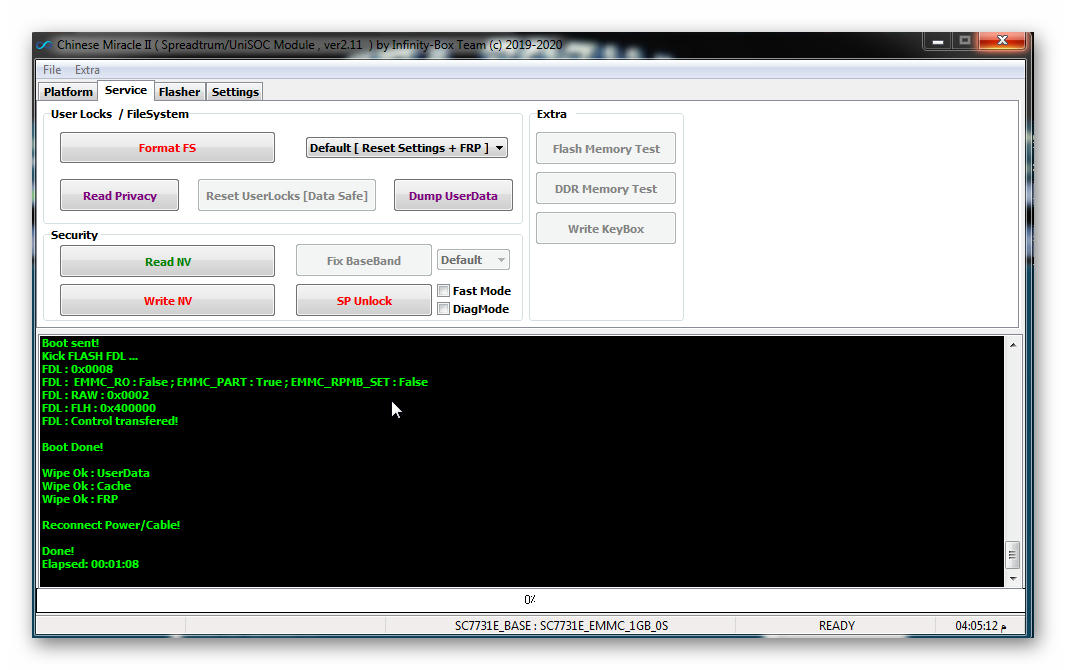

Operation : Format FS / Reset Settings [ v2.11 ]
Mode : Default [ Reset Settings + FRP ]
BootMode : FLASH
Wait for device ...
Device Connected!
>>> ERROR : Protocol HandShake failed!
>>> Error : Fail to init protocol!
>>> Remove battery, cable. Check cable and connection. Repeat operation!
Reconnect Power/Cable!
BootMode : FLASH
Wait for device ...
Device Connected!
BootVersion : SPRD3
Boot sent!
Kick FDL ...
Protocol setup ...
Port speed : 921600
Boot sent!
Kick FLASH FDL ...
FDL : 0x0008
FDL : RAW : 0x0002
Boot Done!
Wipe Ok : UserData
Wipe Ok : Cache
Wipe Ok : FRP
Done!
Elapsed: 00:01:08
