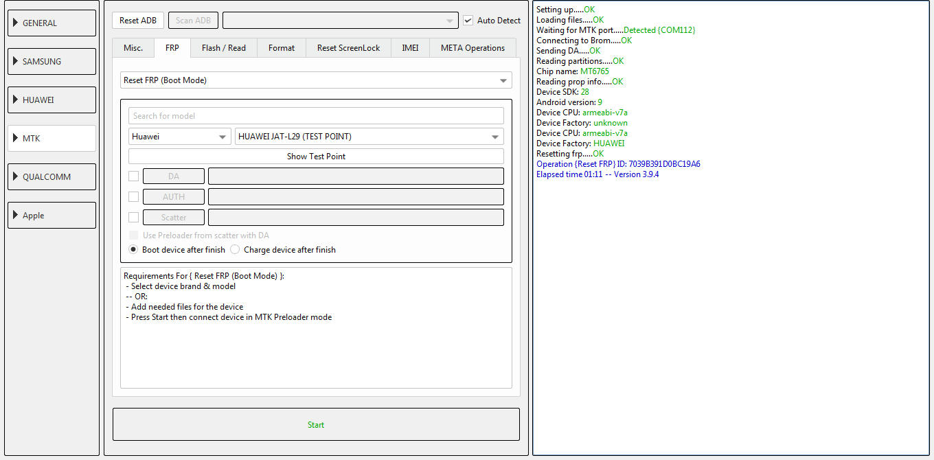

Searching device by fastboot...
Device found
Reading device Information...
Device Model : JAT-L29
Device Firmware : JAT-L29HW 9.1.0.403(C185E3R1P2)
Country : MIDDLE EAST and AFRICA
Current Status : SAFE
FB Lock : LOCK
FRP Unlock : LOCK
Setting up.....OK
Loading files.....OK
Waiting for MTK port.....Detected {COM112}
Connecting to Brom.....OK
Sending DA.....OK
Reading partitions.....OK
Chip name: MT6765
Reading prop info.....OK
Device SDK: 28
Android version: 9
Device CPU: armeabi-v7a
Device Factory: unknown
Device Factory: HUAWEI
Resetting frp.....OK
Operation {Reset FRP} ID: 7039B391D0BC19A6
Elapsed time 01:11 -- Version 3.9.4
