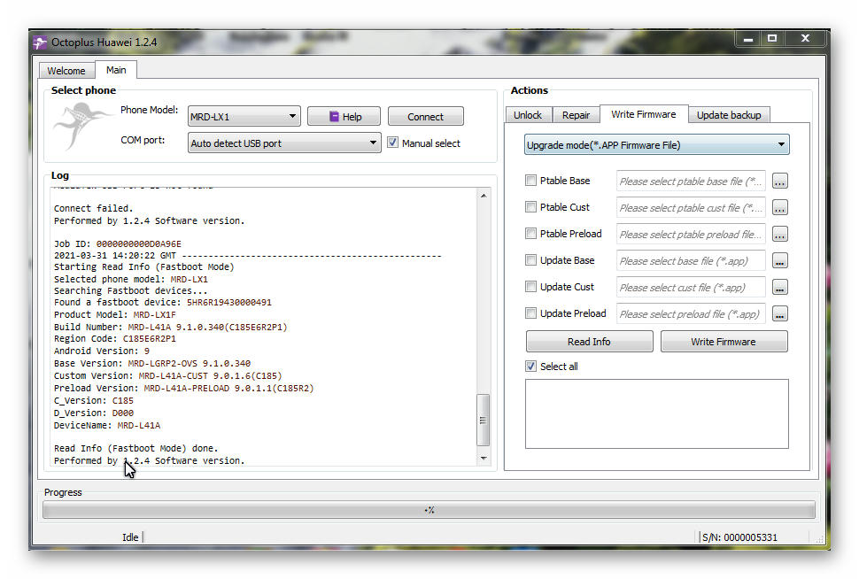

Welcome to Octoplus Huawei Software v.â€ھ1.2.4‬
Job ID: 0000000000D0A96E
2021-03-31 14:20:22 GMT -------------------------------------------------
Starting Read Info (Fastboot Mode)
Selected phone model: â€ھMRD-LX1‬
Searching Fastboot devices...
Found a fastboot device: 5HR6R19430000491
Product Model: â€ھMRD-LX1F‬
Build Number: â€ھMRD-L41A 9.1.0.340(C185E6R2P1)‬
Region Code: C185E6R2P1
Android Version: â€ھ9‬
Base Version: â€ھMRD-LGRP2-OVS 9.1.0.340‬
Custom Version: â€ھMRD-L41A-CUST 9.0.1.6(C185)‬
Preload Version: â€ھMRD-L41A-PRELOAD 9.0.1.1(C185R2)‬
C_Version: â€ھC185‬
D_Version: â€ھD000‬
DeviceName: â€ھMRD-L41A‬

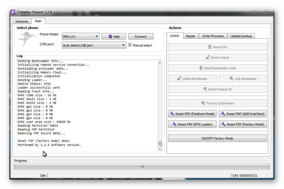

Job ID: 0000000000D0ADC6
2021-03-31 14:30:01 GMT -------------------------------------------------
Starting Reset FRP (Factory Mode)
Please, put your device in Factory mode (use "ON/OFF Factory Mode" option or Hardware Test Point) and insert USB cable
Detected â€ھMediaTek USB Port_V1632‬ port
Detecting Chip Version...
HW Chip : MT6761
HW Version : 8A00.CA01.0200.0000
Brom Version: 5
Boot Loader Version: FE
Initializing remote service connection...
Downloading Authentication Data...
Sending Authentication Data...
Downloading Download Agent data...
Using MTK_AllInOne_DA_v3.3001.2018/10/18.17:38_452898 download agent...
Found a suitable Download agent.
Sending Download Agent...
DA successfully sent
Synchronizing with DA...
Mobile Status: SYNC
Mobile Status: brom
Sending BootLoader Info...
Downloading preloader data...
Initializing Memory Flash...
Initialization completed
Sending Loader...
Mobile Status: SYNC
Loader successfully sent
Reading Flash Info...
EMMC rpmb size : 16 Mb
EMMC boot1 size : 4 Mb
EMMC boot2 size : 4 Mb
EMMC gp1 size : 0 Mb
EMMC gp2 size : 0 Mb
EMMC gp3 size : 0 Mb
EMMC gp4 size : 0 Mb
EMMC user area size : 29820 Mb
Reading Partition Table
Reading FRP Partition
Removing FRP secure data...
Reset FRP (Factory Mode) done.
Performed by â€ھ1.2.4‬ Software version.
