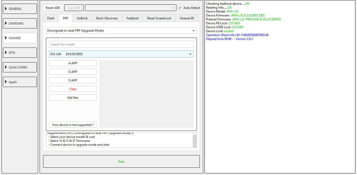

[SIZE=5]Reading info.....OK [/SIZE]
[SIZE=5]Device Model: JKM-LX1 [/SIZE]
[SIZE=5]Device Firmware: :JKM-LX1 8.2.0.160(C185) [/SIZE]
[SIZE=5]Preload Firmware: :JKM-L21-PRELOAD 8.2.0.2(C185R2) [/SIZE]
[SIZE=5]Device FB Lock: LOCKED [/SIZE]
[SIZE=5]Device USER Lock: LOCKED [/SIZE]
[SIZE=5]Device Lock: locked [/SIZE]
[SIZE=5]Operation {Read info} ID: FA8EB5E808F09DAB [/SIZE]
[SIZE=5]Elapsed time 00:06 -- Version 3.9.1[/SIZE]

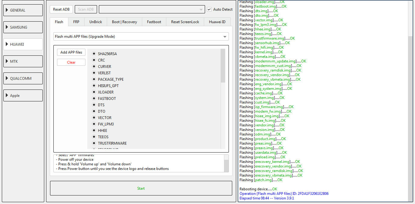

[SIZE=5]
[/SIZE][SIZE=5]Searching for upgrade port.....Detected {COM228} [/SIZE]
[SIZE=5]Connecting to device.....OK [/SIZE]
[SIZE=5]Start processing file [D:/New folder (5)/UPDATE.APP] 3,42 GB: [/SIZE]
[SIZE=5]Flashing [sha256rsa.img].....OK [/SIZE]
[SIZE=5]Flashing [crc.img].....OK [/SIZE]
[SIZE=5]Flashing [curver.img].....OK [/SIZE]
[SIZE=5]Flashing [verlist.img].....OK [/SIZE]
[SIZE=5]Flashing [package_type.img].....OK [/SIZE]
[SIZE=5]Flashing [hisiufs_gpt.img].....OK [/SIZE]
[SIZE=5]Flashing [xloader.img].....OK [/SIZE]
[SIZE=5]Flashing [fastboot.img].....OK [/SIZE]
[SIZE=5]Flashing [dts.img].....OK [/SIZE]
[SIZE=5]Flashing [dto.img].....OK [/SIZE]
[SIZE=5]Flashing [vector.img].....OK [/SIZE]
[SIZE=5]Flashing [fw_lpm3.img].....OK [/SIZE]
[SIZE=5]Flashing [hhee.img].....OK [/SIZE]
[SIZE=5]Flashing [teeos.img].....OK [/SIZE]
[SIZE=5]Flashing [trustfirmware.img].....OK [/SIZE]
[SIZE=5]Flashing [sensorhub.img].....OK [/SIZE]
[SIZE=5]Flashing [fw_hifi.img].....OK [/SIZE]
[SIZE=5]Flashing [kernel.img].....OK [/SIZE]
[SIZE=5]Flashing [vbmeta.img].....OK [/SIZE]
[SIZE=5]Flashing [modemnvm_update.img].....OK [/SIZE]
[SIZE=5]Flashing [modemnvm_cust.img].....OK [/SIZE]
[SIZE=5]Flashing [recovery_ramdisk.img].....OK [/SIZE]
[SIZE=5]Flashing [recovery_vendor.img].....OK [/SIZE]
[SIZE=5]Flashing [recovery_vbmeta.img].....OK [/SIZE]
[SIZE=5]Flashing [eng_vendor.img].....OK [/SIZE]
[SIZE=5]Flashing [eng_system.img].....OK [/SIZE]
[SIZE=5]Flashing [cache.img].....OK [/SIZE]
[SIZE=5]Flashing [system.img].....OK [/SIZE]
[SIZE=5]Flashing [cust.img].....OK [/SIZE]
[SIZE=5]Flashing [isp_firmware.img].....OK [/SIZE]
[SIZE=5]Flashing [modem_fw.img].....OK [/SIZE]
[SIZE=5]Flashing [hisee_img.img].....OK [/SIZE]
[SIZE=5]Flashing [hisee_fs.img].....OK [/SIZE]
[SIZE=5]Flashing [vendor.img].....OK [/SIZE]
[SIZE=5]Flashing [version.img].....OK [/SIZE]
[SIZE=5]Flashing [odm.img].....OK [/SIZE]
[SIZE=5]Flashing [product.img].....OK [/SIZE]
[SIZE=5]Flashing [preas.img].....OK [/SIZE]
[SIZE=5]Flashing [preavs.img].....OK [/SIZE]
[SIZE=5]Flashing [userdata.img].....OK [/SIZE]
[SIZE=5]Flashing [preload.img].....OK [/SIZE]
[SIZE=5]Flashing [erecovery_kernel.img].....OK [/SIZE]
[SIZE=5]Flashing [erecovery_vendor.img].....OK [/SIZE]
[SIZE=5]Flashing [erecovery_ramdisk.img].....OK [/SIZE]
[SIZE=5]Flashing [erecovery_vbmeta.img].....OK [/SIZE]
[SIZE=5]Flashing [patch.img].....OK [/SIZE]
[SIZE=5]
[/SIZE]
[SIZE=5]Rebooting device.....OK [/SIZE]
[SIZE=5]Operation {Flash multi APP files} ID: 2FDA1F32061E2B06 [/SIZE]
[SIZE=5]Elapsed time 08:44 -- Version 3.9.1[/SIZE]
