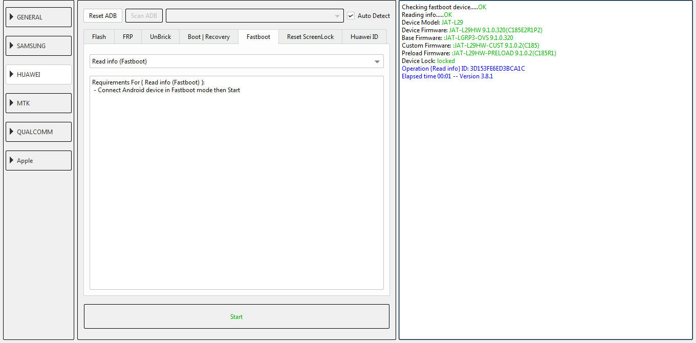

ازالة قفل FRP لهاتف Huawei Y6s (2019) JAT-L29 بالتيست بوينت 9.1.0.320
4,641
8,304
Reading info.....OK
Device Model: JAT-L29
Device Firmware: JAT-L29HW 9.1.0.320(C185E2R1P2)
Base Firmware: :JAT-LGRP3-OVS 9.1.0.320
Custom Firmware: :JAT-L29HW-CUST 9.1.0.2(C185)
Preload Firmware: :JAT-L29HW-PRELOAD 9.1.0.2(C185R1)
Device Lock: locked
Operation {Read info} ID: 3D153FE6ED3BCA1C
Elapsed time 00:01 -- Version 3.8.1
Setting up.....OK
Loading files.....OK
Waiting for MTK port.....Detected {COM112}
Connecting to Brom.....OK
Sending DA.....OK
Reading partitions.....OK
Chip name: MT6765
Reading prop info.....OK
Device SDK: 28
Android version: 9
Device CPU: armeabi-v7a
Device Factory: unknown
Device Factory: HUAWEI
Resetting frp.....OK
Operation {Reset FRP} ID: 8BB1965172718185
Elapsed time 00:22 -- Version 3.8.1
