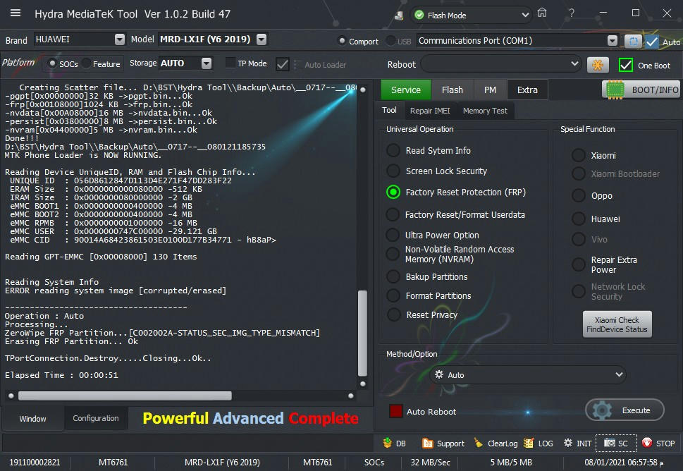

ازالة قفل FRP ل Huawei Y6 Prime 2019 MRD-LX1F بالتيست بوينت
4,371
8,086
firmware MRD-L41A 9.1.0.324(C185E5R4P1)
Hydra MediaTeK Tool Ver 1.0.2 Build 47
Windows 7 Service Pack 1 (Version 6.1, Build 7601, 32-bit Edition)
Intel(R) Core(TM) i3 CPU 540 @ 3.07GHz
Intel(R) HD Graphics
Ram Installed : 3 GB
Windows Access Right Admin
Software Run As Admnistrator
******* Dongle Info *******
Version : Hydra Tool v 1.1
Serial : 191100002821
Initialize : OKAY
Status : Activated
Life : 1 [3-0-0-0-0]
Brand : HUAWEI Model : MRD-LX1F (Y6 2019) Connection : Flash Mode
Connection
-Please wait...
-Connect Phone...
-Found...[COM115]
TPortConnection.Create...(COM115)..Opening...Ok
Handshaking...Ok
Identifying Hardware ID.....
BROM CPUID : 0717 (0000)MT6761[6761]
BROM HW_SW_VER : 8A00 CA01 0200 0000
FUSEID : 00000000
SECURE VERSION : 05
BL VERSION : FE
BR Secured : E5[SBC+SDA+SEL]
Security Authorization....
Sending[Huawei_auth_sv5_.auth] Accepted
Preparing Download Agent..
DA : Huawei_6761_8A00CA0000000000_00001000_00030000.bin
Agent: MTK_DOWNLOAD_AGENT -HYDRA
Ver : MTK_AllInOne_DA_v3.3001.2018/10/18.17:38_452898
Init : Loader [1]
Sending : Accepted
Identifying Protocol...
Protocol : New
Synchronization...SYNC
Mode : brom
Preloader Initialization...
Parsing preloader_k61v1_64_mexico.bin
Init : Accepted
Execute Secondary Loader
Init : Loader [2]
Executing : SYNC
Reading Device UniqueID, RAM and Flash Chip Info...
UNIQUE ID : 056D8612847D113D4E271F47DD283F22
ERAM Size : 0x0000000000080000 -512 KB
IRAM Size : 0x0000000080000000 -2 GB
eMMC BOOT1 : 0x0000000000400000 -4 MB
eMMC BOOT2 : 0x0000000000400000 -4 MB
eMMC RPMB : 0x0000000001000000 -16 MB
eMMC USER : 0x0000000747C00000 -29.121 GB
eMMC CID : 90014A68423861503E0100D177B34771 - hB8aP>
DA Speed : high-speed
Reading GPT-EMMC [0x00008000] 130 Items
Reading System Info
ERROR reading system image [corrupted/erased]
Autobackup Partitions
-preloader[0x00000000]512 KB ->preloader.bin...Ok
-> Renaming Preloader.... preloader_k61v1_64_mexico.bin
Creating Scatter file... D:\BST\Hydra Tool\\Backup\Auto\__0717--__080121185735\MT6761_Android_scatter.txt
-pgpt[0x00000000]32 KB ->pgpt.bin...Ok
-frp[0x00108000]1024 KB ->frp.bin...Ok
-nvdata[0x00A08000]16 MB ->nvdata.bin...Ok
-persist[0x03800000]8 MB ->persist.bin...Ok
-nvram[0x04400000]5 MB ->nvram.bin...Ok
Done!!!
MTK Phone Loader is NOW RUNNING.
Reading System Info
Operation : Auto
Processing...
ZeroWipe FRP Partition...[C002002A-STATUS_SEC_IMG_TYPE_MISMATCH]
Erasing FRP Partition... Ok
TPortConnection.Destroy.....Closing...Ok..
Elapsed Time : 00:00:51
