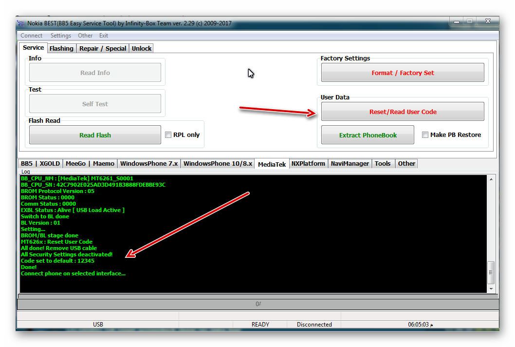

لاول مرة ازالة رمز القفل لهاتف Nokia 125 TA 1253
الحالة
4,418
8,102
Registered to: profkefah
Connect phone on selected interface...
Dead Mode is Selected
Waiting for USB device...
1. Phone should be Off!
2. Battery must be charged and inserted! ( if not used external power )
- > If phone can't switch to BL - use battery or flash from Local mode!
--- Insert USB cable now! ---
Wait for phone...
Phone found! [ 99 ]
Sync...
Sync Ok, read regs...
Inital regs read done
Boot Info :
BB_CPU_ID : 6261
BB_CPU_HW : CB01
BB_CPU_SW : 0001
BB_CPU_SB : 8000
BB_CPU_NM : [MediaTek] MT6261_S0001
BB_CPU_SN : 42C7902E025AD3D491B3888FDEBBE93C
BROM Protocol Version : 05
BROM Status : 0000
Comm Status : 0000
EXBL Status : Alive [ USB Load Active ]
Switch to BL done
BL Version : 01
Setting...
BROM/BL stage done
MT626x : Reset User Code
All done! Remove USB cable
All Security Settings deactivated!
Code set to default : 12345
Done!
Wait for phone...
Phone found! [ 99 ]
Sync...
Boot Info :
BB_CPU_ID : 6261
BB_CPU_HW : CB01
BB_CPU_SW : 0001
BB_CPU_SB : 8000
BROM Status : 0000
Comm Status : 0000
Switch to BL done
BL Version : 01
Setting...
BROM/BL stage done
Done!
