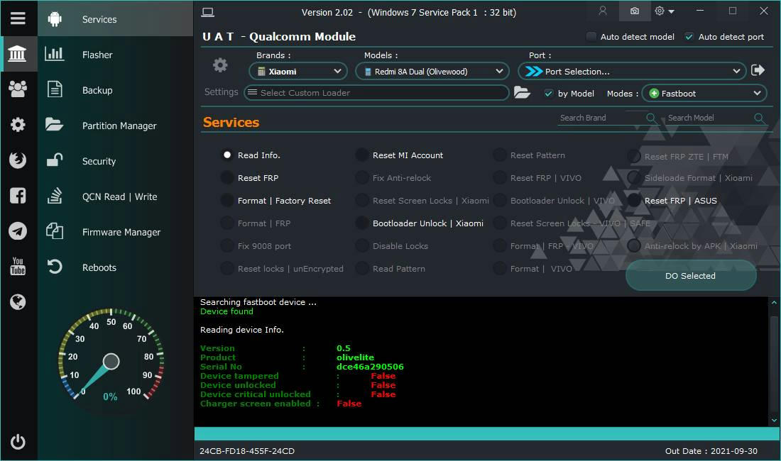

معلومات الفاست بوت
Searching fastboot device ...
Device found
Reading device Info.
Version     :    0.5
Product     :    olivelite
Serial No     :    dce46a290506
Device tampered     :    False
Device unlocked     :    False
Device critical unlocked    :    False
Charger screen enabled :    False

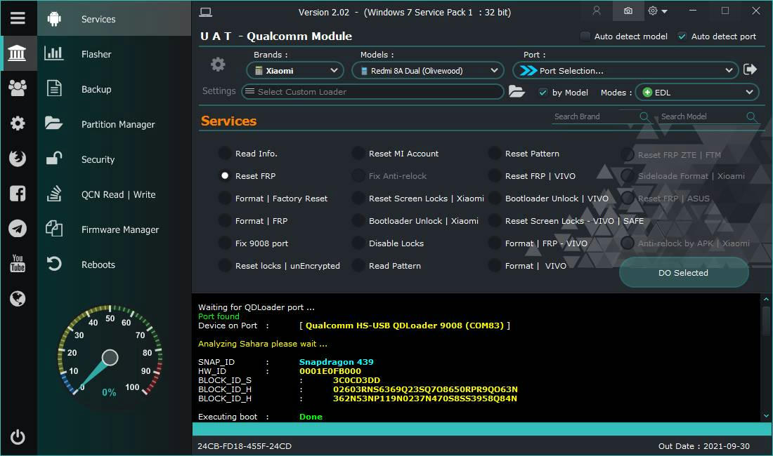

نقاط الاختبار (التيست بوينت)

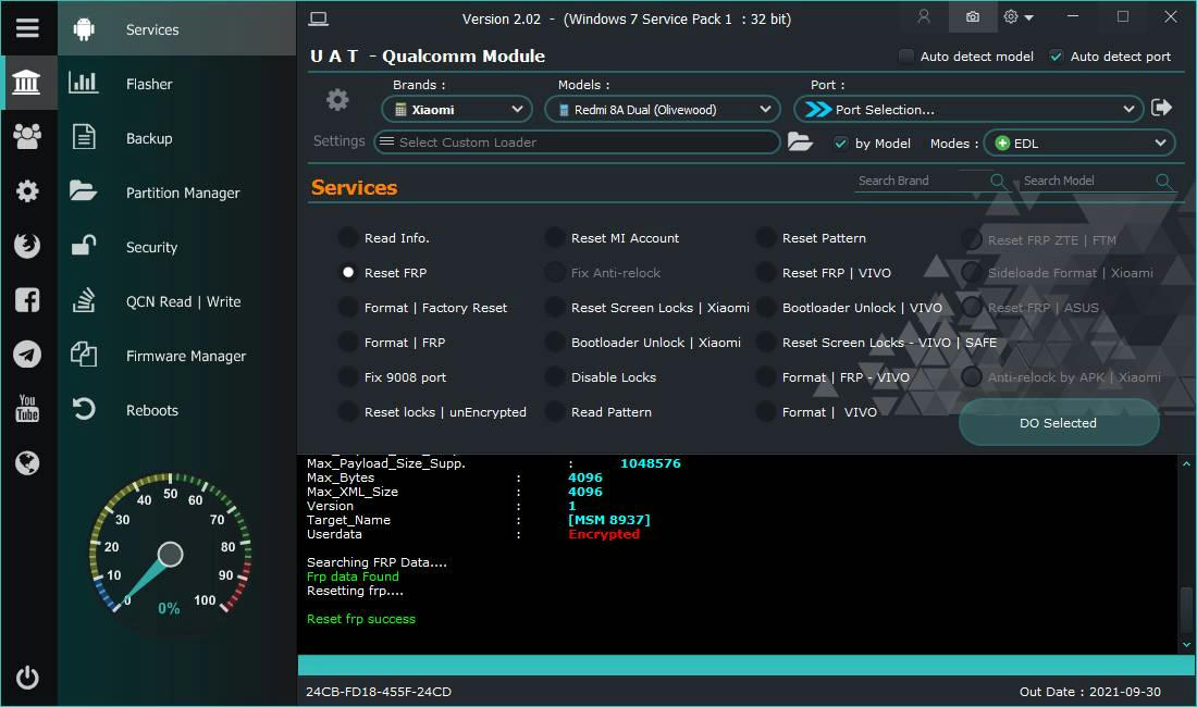

Waiting for QDLoader port ...
Port found
Device on Port    :    [ Qualcomm HS-USB QDLoader 9008 (COM83) ]
Analyzing Sahara please wait ...
SNAP_ID             :    Snapdragon 439
HW_ID               :    0001E0FB000
BLOCK_ID_S          :    3C0CD3DD
BLOCK_ID_H          :    02603RNS6369Q23SQ7O8650RPR9QO63N
BLOCK_ID_H          :    362N53NP119N0237N470S8SS3958Q84N
Executing boot      :    Done
Configuring         :    Failed
Device requires Authorization
Connecting to UAT Server
Checking UAT Server Online Status
UAT Server is Online
Reading Authorization Blob... OK
Blob : [ qlpLQrtWu/yzXKGlgkwiW6WF5StzHadYnzR/acXvIKdpAHYAZQB3AG8 ]
Sending request to Server
Waiting for Signature @256bytes Authentication
Signature Authentication Accepted
Configuring    :    Done
Reading Parts       :    Done
Partition Count     :    34
MEM_TYPE                          :    eMMC
Max_Payload_Size_InBytes     :    1048576
Max_Payload_Size_Supp.          :    1048576
Max_Bytes                        :    4096
Max_XML_Size                     :    4096
Version                          :    1
Target_Name                      :    [MSM 8937]
Userdata                         :    Encrypted
Searching FRP Data....
Frp data Found
Resetting frp....
Reset frp success
