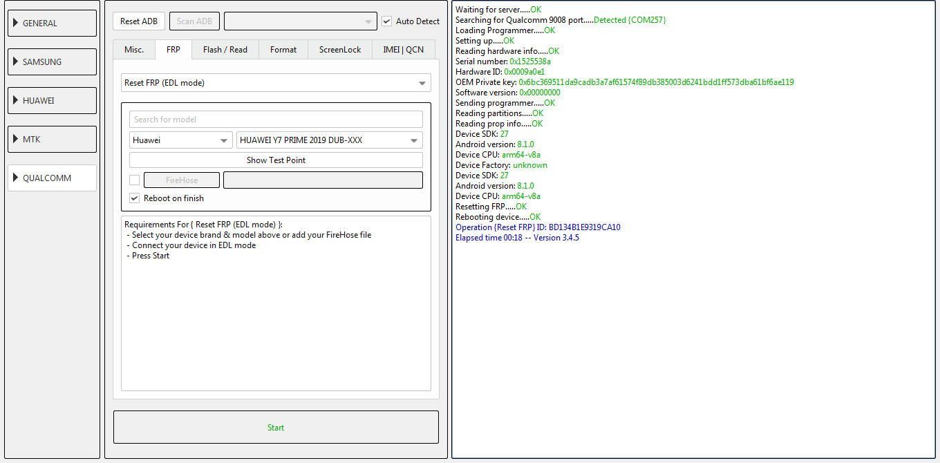

ازالة قفل FRP لهاتف Huawei Y7 Prime 2019 DUB-LX1 بالتيست بوينت

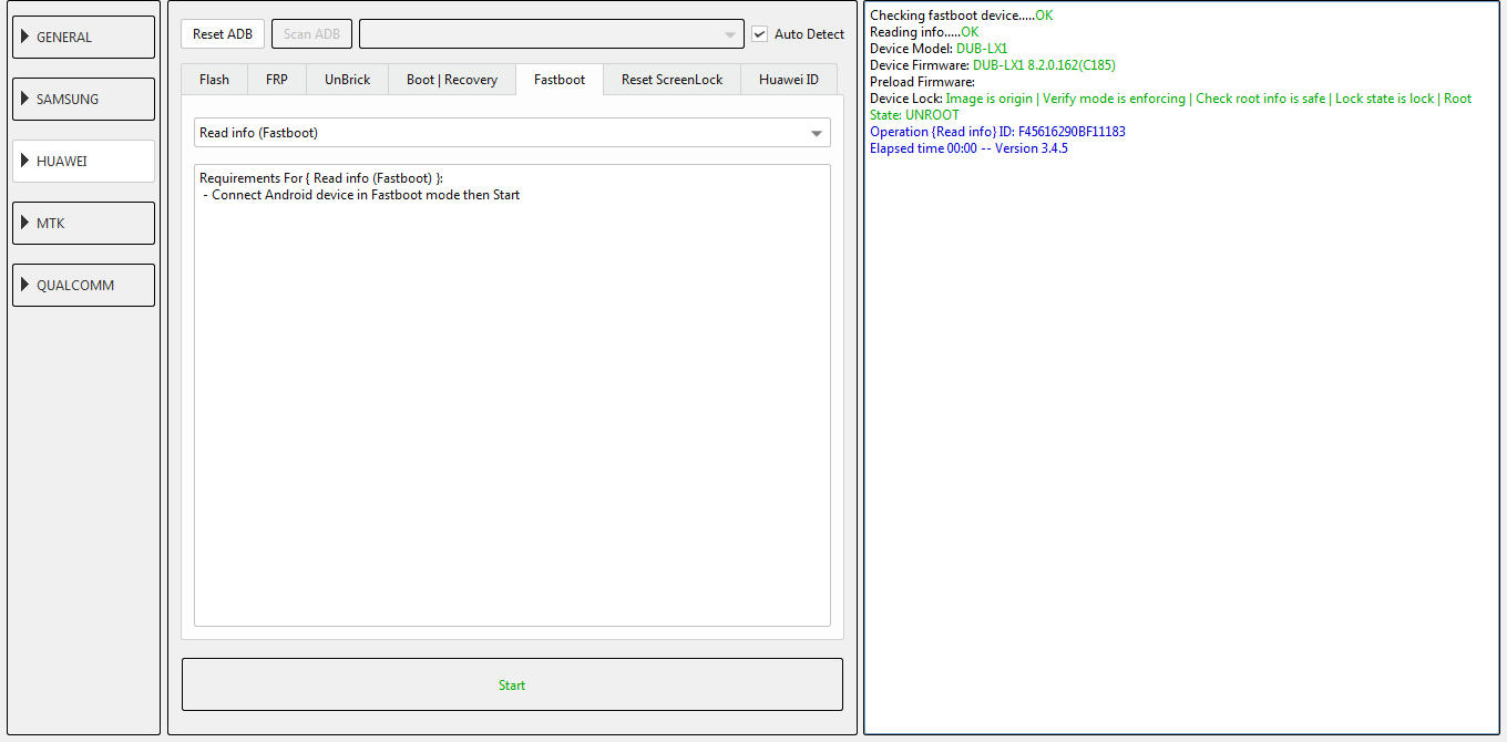

Reading info.....OK
Device Model: DUB-LX1
Device Firmware: DUB-LX1 8.2.0.162(C185)
Preload Firmware:
Device Lock: Image is origin | Verify mode is enforcing | Check root info is safe | Lock state is lock | Root State: UNROOT
Operation {Read info} ID: F45616290BF11183
Elapsed time 00:00 -- Version 3.4.5
Waiting for server.....OK
Searching for Qualcomm 9008 port.....Detected {COM257}
Loading Programmer.....OK
Setting up.....OK
Reading hardware info.....OK
Serial number: 0x1525538a
Hardware ID: 0x0009a0e1
OEM Private key: 0x6bc369511da9cadb3a7af61574f89db385003d6241bdd1ff 573dba61bf6ae119
Software version: 0x00000000
Sending programmer.....OK
Reading partitions.....OK
Reading prop info.....OK
Device SDK: 27
Android version: 8.1.0
Device CPU: arm64-v8a
Device Factory: unknown
Device SDK: 27
Resetting FRP.....OK
Rebooting device.....OK
Operation {Reset FRP} ID: BD134B1E9319CA10
Elapsed time 00:18 -- Version 3.4.5
