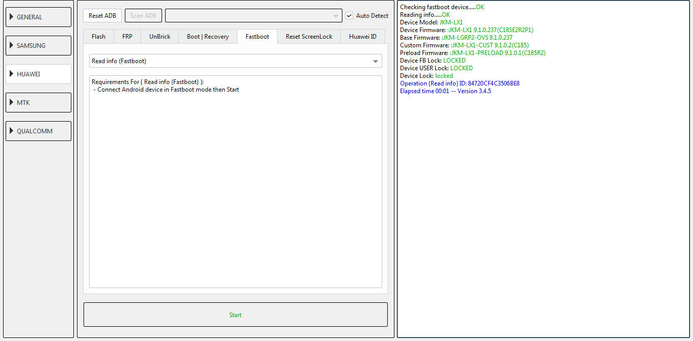

معلومات الفاست بوت
Reading info.....OK
Device Model: JKM-LX1
Device Firmware: :JKM-LX1 9.1.0.237(C185E2R2P1)
Base Firmware: :JKM-LGRP2-OVS 9.1.0.237
Custom Firmware: :JKM-LX1-CUST 9.1.0.2(C185)
Preload Firmware: :JKM-LX1-PRELOAD 9.1.0.1(C185R2)
Device FB Lock: LOCKED
Device USER Lock: LOCKED
Device Lock: locked
Operation {Read info} ID: 84720CF4C3506BE8
Elapsed time 00:01 -- Version 3.4.5

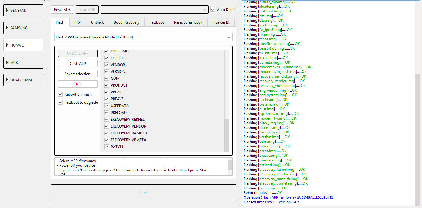

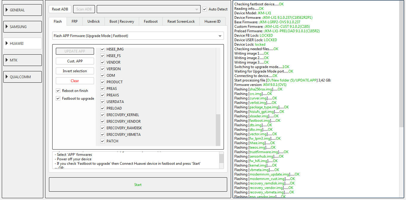

التفليش
Reading info.....OK
Device Lock: locked
Checking needed files.....OK
Writing image 1.....OK
Writing image 2.....OK
Writing image 3.....OK
Switching to upgrade mode.....1OK
Connecting to device.....OK
Start processing file [D:/New folder (5)/UPDATE.APP] 3,42 GB:
Firmware version: JKM 9.0.1(OVS)
Flashing [crc.img].....OK
Flashing [curver.img].....OK
Flashing [verlist.img].....OK
Flashing [xloader.img].....OK
Flashing [dts.img].....OK
Flashing [dto.img].....OK
Flashing [vector.img].....OK
Flashing [fw_lpm3.img].....OK
Flashing [hhee.img].....OK
Flashing [teeos.img].....OK
Flashing [fw_hifi.img].....OK
Flashing [kernel.img].....OK
Flashing [vbmeta.img].....OK
Flashing [cache.img].....OK
Flashing [system.img].....OK
Flashing [cust.img].....OK
Flashing [vendor.img].....OK
Flashing [version.img].....OK
Flashing [odm.img].....OK
Flashing [product.img].....OK
Flashing [preas.img].....OK
Flashing [preavs.img].....OK
Flashing [preload.img].....OK
Flashing [patch.img].....OK
Rebooting device.....OK
Operation {Flash APP Firmware} ID: 1D48A55E5201BF41
Elapsed time 06:59 -- Version 3.4.5​
