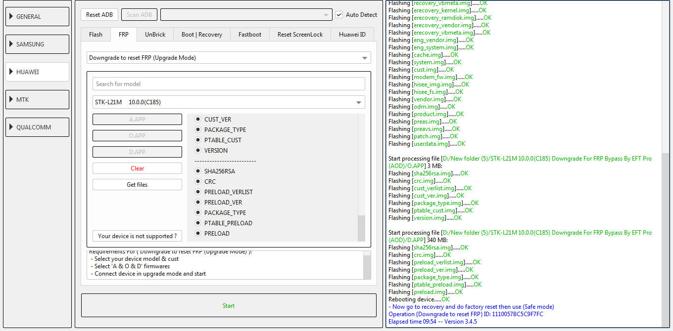

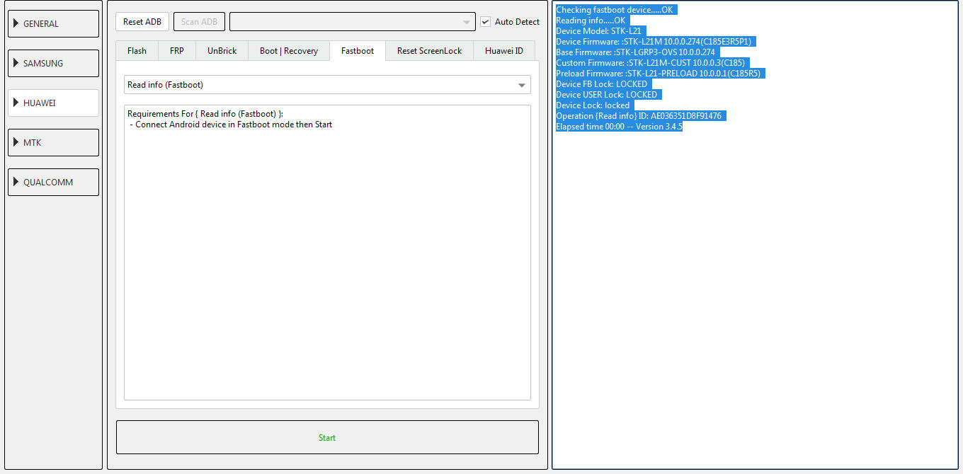

لكن الحمايه STK-L21M 10.0.0.274
Reading info.....OK
Device Model: STK-L21
Device Firmware: :STK-L21M 10.0.0.274(C185E3R5P1)
Base Firmware: :STK-LGRP3-OVS 10.0.0.274
Custom Firmware: :STK-L21M-CUST 10.0.0.3(C185)
Preload Firmware: :STK-L21-PRELOAD 10.0.0.1(C185R5)
Device FB Lock: LOCKED
Device USER Lock: LOCKED
Device Lock: locked
Operation {Read info} ID: AE036351D8F91476
Elapsed time 00:00 -- Version 3.4.5
Searching for upgrade port.....Detected {COM189}
Target model [STK-L21M 10.0.0(C185)]
Reading data from server.....OK
Bypassing downgrade protection.....OK
Rebooting device.....OK
Waiting device to reboot.....19OK
- Reboot your device to upgrade mode:
1 - Reboot to recovery by Volume up button
2 - Press on (Update mode)
3 - Press on (USB update mode)
Waiting for upgrade mode device.....OK
Connecting to device.....OK
Start processing file [D:/New folder (5)/STK-L21M 10.0.0(C185) Downgrade For FRP Bypass By EFT Pro (AOD)/A.APP] 3,80 GB:
Flashing [crc.img].....OK
Flashing [base_verlist.img].....OK
Flashing [base_ver.img].....OK
Flashing [xloader.img].....OK
Flashing [hhee.img].....OK
Flashing [dts.img].....OK
Flashing [fw_lpm3.img].....OK
Flashing [dto.img].....OK
Flashing [kernel.img].....OK
Flashing [teeos.img].....OK
Flashing [vector.img].....OK
Flashing [fw_hifi.img].....OK
Flashing [vbmeta.img].....OK
Flashing [cache.img].....OK
Flashing [system.img].....OK
Flashing [cust.img].....OK
Flashing [vendor.img].....OK
Flashing [odm.img].....OK
Flashing [product.img].....OK
Flashing [preas.img].....OK
Flashing [preavs.img].....OK
Flashing [patch.img].....OK
Start processing file [D:/New folder (5)/STK-L21M 10.0.0(C185) Downgrade For FRP Bypass By EFT Pro (AOD)/O.APP] 3 MB:
Flashing [cust_verlist.img].....OK
Flashing [cust_ver.img].....OK
Flashing [ptable_cust.img].....OK
Flashing [version.img].....OK
Start processing file [D:/New folder (5)/STK-L21M 10.0.0(C185) Downgrade For FRP Bypass By EFT Pro (AOD)/D.APP] 340 MB:
Flashing [preload_verlist.img].....OK
Flashing [preload_ver.img].....OK
Flashing [ptable_preload.img].....OK
Flashing [preload.img].....OK
- Now go to recovery and do factory reset then use (Safe mode)
Operation {Downgrade to reset FRP} ID: 1110057BC5C9F7FC
Elapsed time 09:54 -- Version 3.4.5
