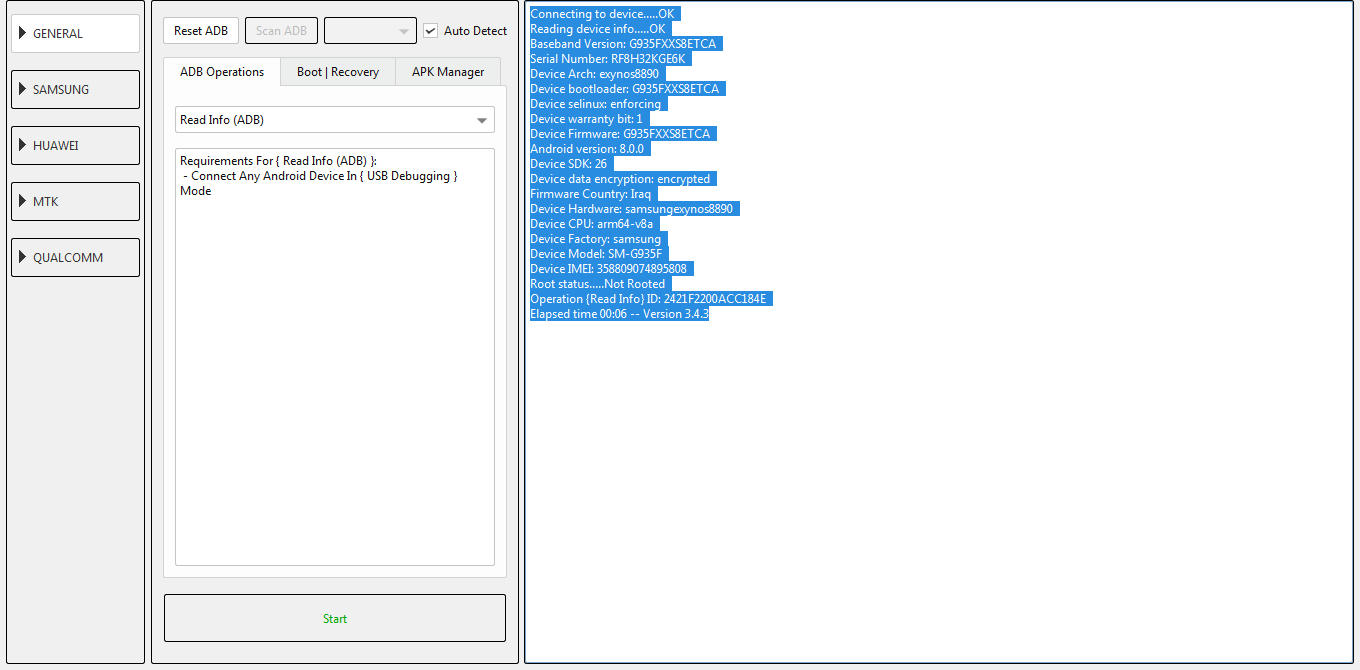

Connecting to device.....OK Reading device info.....OK
Baseband Version: G935FXXS8ETCA
Serial Number: RF8H32KGE6K
Device Arch: exynos8890
Device bootloader: G935FXXS8ETCA
Device selinux: enforcing
Device warranty bit: 1
Device Firmware: G935FXXS8ETCA
Android version: 8.0.0
Device SDK: 26
Device data encryption: encrypted
Firmware Country: Iraq
Device Hardware: samsungexynos8890
Device CPU: arm64-v8a
Device Factory: samsung
Device Model: SM-G935F
Device IMEI: 358809074895808
Root status.....Not Rooted
Operation {Read Info} ID: 2421F2200ACC184E
Elapsed time 00:06 -- Version 3.4.3

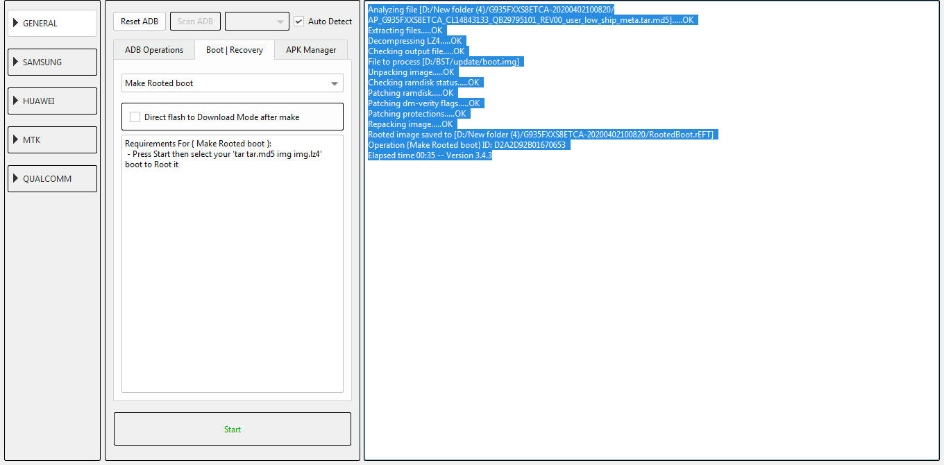

Analyzing file [D:/New folder (4)/G935FXXS8ETCA-20200402100820/AP_G935FXXS8ETCA_CL14843133_QB29795101_REV00_user_low_ship_meta.tar.md5].....OK
Extracting files.....OK
Decompressing LZ4.....OK
Checking output file.....OK
File to process [D:/BST/update/boot.img]
Unpacking image.....OK
Checking ramdisk status.....OK
Patching ramdisk.....OK
Patching dm-verity flags.....OK
Patching protections.....OK
Repacking image.....OK
Rooted image saved to [D:/New folder (4)/G935FXXS8ETCA-20200402100820/RootedBoot.rEFT]
Operation {Make Rooted boot} ID: D2A2D92B01670653

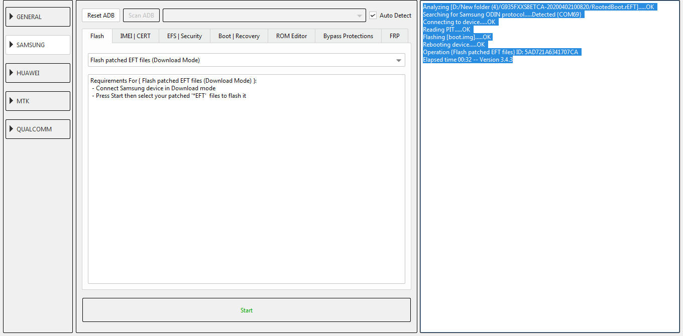

Analyzing [D:/New folder (4)/G935FXXS8ETCA-20200402100820/RootedBoot.rEFT].....OK
Searching for Samsung ODIN protocol.....Detected {COM69}
Reading PIT.....OK
Flashing [boot.img].....OK
Rebooting device.....OK
Operation {Flash patched EFT files} ID: 5AD721A6341707CA
Elapsed time 00:32 -- Version 3.4.3

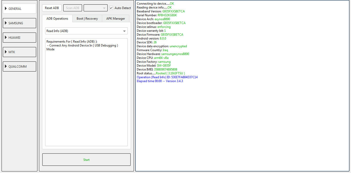

Device SDK: 26
Device data encryption: unencrypted
Root status.....Rooted { 3.19:EFTSU }
Operation {Read Info} ID: 53EE7FA884D37C14
Elapsed time 00:00 -- Version 3.4.3
