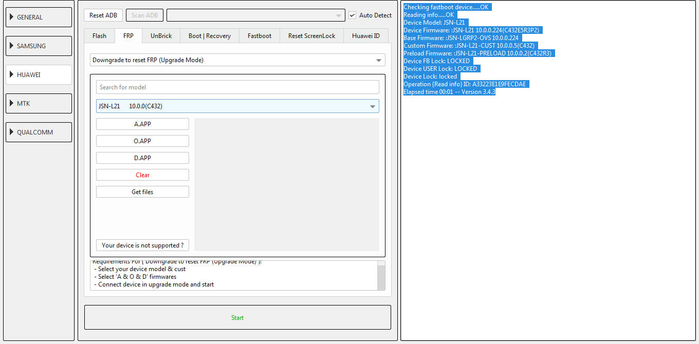

عمل داونجريد لهاتفHuawei Honor 8X Global JSN-LX1 لازالة قفل frp بال safe mode
4,540
8,217
Checking fastboot device.....OK Reading info.....OK
Device Model: JSN-L21
Device Firmware: :JSN-L21 10.0.0.224(C432E5R3P2)
Base Firmware: :JSN-LGRP2-OVS 10.0.0.224
Custom Firmware: :JSN-L21-CUST 10.0.0.5(C432)
Preload Firmware: :JSN-L21-PRELOAD 10.0.0.2(C432R3)
Device FB Lock: LOCKED
Device USER Lock: LOCKED
Device Lock: locked
Operation {Read info} ID: A33223E1E9FECDAE
Elapsed time 00:01 -- Version 3.4.3

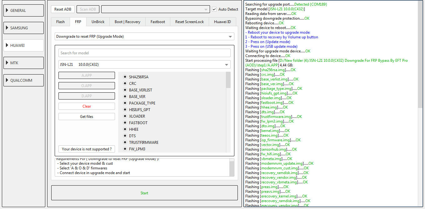

في البدء فلش الملفات
A O D
Searching for upgrade port.....Detected {COM189}
Target model [JSN-L21 10.0.0(C432)]
Reading data from server.....OK
Bypassing downgrade protection.....OK
Rebooting device.....OK
Waiting device to reboot.....OK
- Reboot your device to upgrade mode:
1 - Reboot to recovery by Volume up button
2 - Press on (Update mode)
3 - Press on (USB update mode)
Waiting for upgrade mode device.....OK
Connecting to device.....OK
Start processing file [D:/New folder (4)/JSN-L21 10.0.0(C432) Downgrade For FRP Bypass By EFT Pro (AOD)/step1/A.APP] 4,44 GB:
Flashing [crc.img].....OK
Flashing [base_verlist.img].....OK
Flashing [base_ver.img].....OK
Flashing [xloader.img].....OK
Flashing [hhee.img].....OK
Flashing [dts.img].....OK
Flashing [fw_lpm3.img].....OK
Flashing [dto.img].....OK
Flashing [kernel.img].....OK
Flashing [teeos.img].....OK
Flashing [vector.img].....OK
Flashing [fw_hifi.img].....OK
Flashing [vbmeta.img].....OK
Flashing [preas.img].....OK
Flashing [preavs.img].....OK
Flashing [cache.img].....OK
Flashing [system.img].....OK
Flashing [cust.img].....OK
Flashing [vendor.img].....OK
Flashing [odm.img].....OK
Flashing [product.img].....OK
Flashing [patch.img].....OK
Flashing [version.img].....OK
Flashing [preload.img].....OK

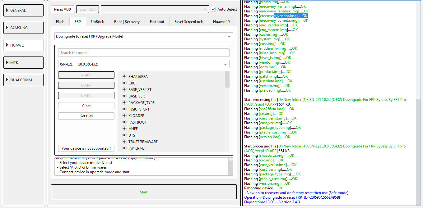

Start processing file [D:/New folder (4)/JSN-L21 10.0.0(C432) Downgrade For FRP Bypass By EFT Pro (AOD)/step1/O.APP] 554 KB:
Flashing [cust_verlist.img].....OK
Flashing [cust_ver.img].....OK
Flashing [ptable_cust.img].....OK
Start processing file [D:/New folder (4)/JSN-L21 10.0.0(C432) Downgrade For FRP Bypass By EFT Pro (AOD)/step1/D.APP] 554 KB:
- Now go to recovery and do factory reset then use (Safe mode)
Operation {Downgrade to reset FRP} ID: 610590C556EA95BF
Elapsed time 13:00 -- Version 3.4.3

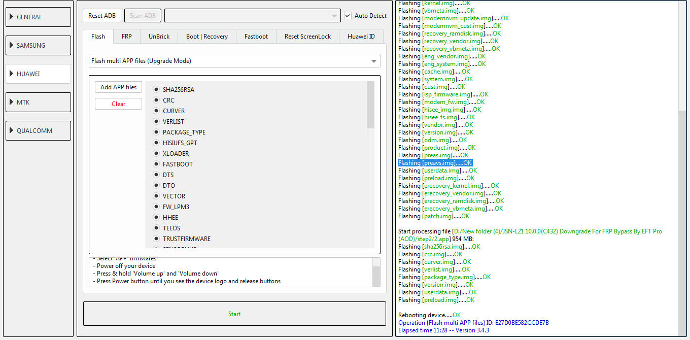

بعدها فلش الملفات
1.APP 2.APP

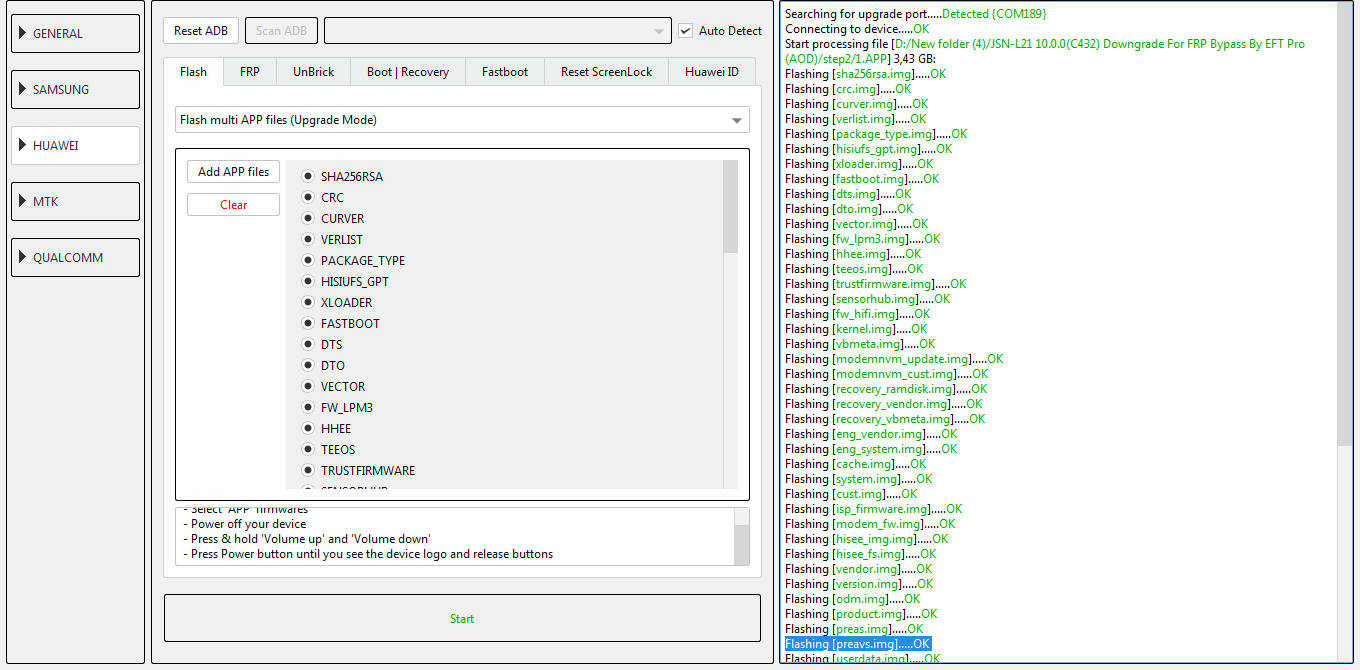

Start processing file [D:/New folder (4)/JSN-L21 10.0.0(C432) Downgrade For FRP Bypass By EFT Pro (AOD)/step2/1.APP] 3,43 GB:
Flashing [curver.img].....OK
Flashing [verlist.img].....OK
Start processing file [D:/New folder (4)/JSN-L21 10.0.0(C432) Downgrade For FRP Bypass By EFT Pro (AOD)/step2/2.app] 954 MB:
Operation {Flash multi APP files} ID: E27D0BE582CCDE7B
Elapsed time 11:28 -- Version 3.4.3
