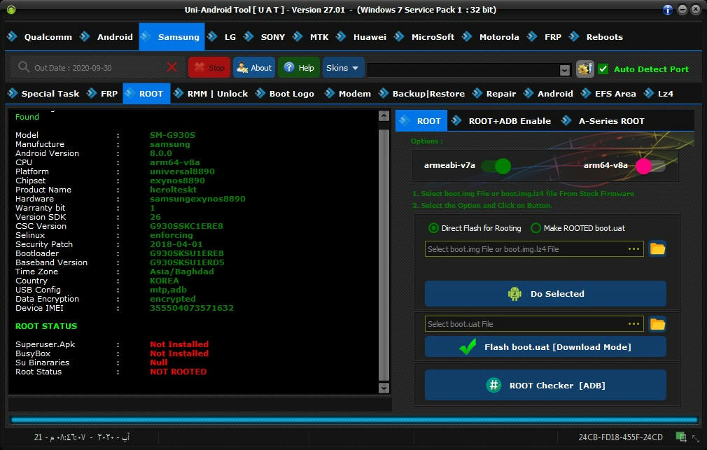

Searching Connected Device ...
Found
Model : SM-G930S
Manufucture : samsung
Android Version : 8.0.0
CPU : arm64-v8a
Platform : universal8890
Chipset : exynos8890
Product Name : herolteskt
Hardware : samsungexynos8890
Warranty bit : 1
Version SDK : 26
CSC Version : G930SSKC1ERE8
Selinux : enforcing
Security Patch : 2018-04-01
Bootloader : G930SKSU1ERE8
Baseband Version : G930SKSU1ERD5
Time Zone : Asia/Baghdad
Country : KOREA
USB Config : mtp,adb
Data Encryption : encrypted
Device IMEI : 355504073571632
ROOT STATUS
Superuser.Apk : Not Installed
BusyBox : Not Installed
Su Binararies : Null
Root Status : NOT ROOTED
Selected File : D:\New folder (4)\G930SKSU1ERE8-20180524094352\boot.img.lz4
File Size : 18.29 MB
Checking File Compataibility ... Done
Build Date : Thu May 10 19:55:55 KST 2018
Fingerprint : samsung/herolteskt/herolteskt:8.0.0/R16NW/G930SKSU1ERE8:user/test-keys
Prepairing Data... Done
Patching boot... Done
All Process Done
File is Successfully Saved in :
D:\New folder (4)\G930SKSU1ERE8-20180524094352\boot.uat

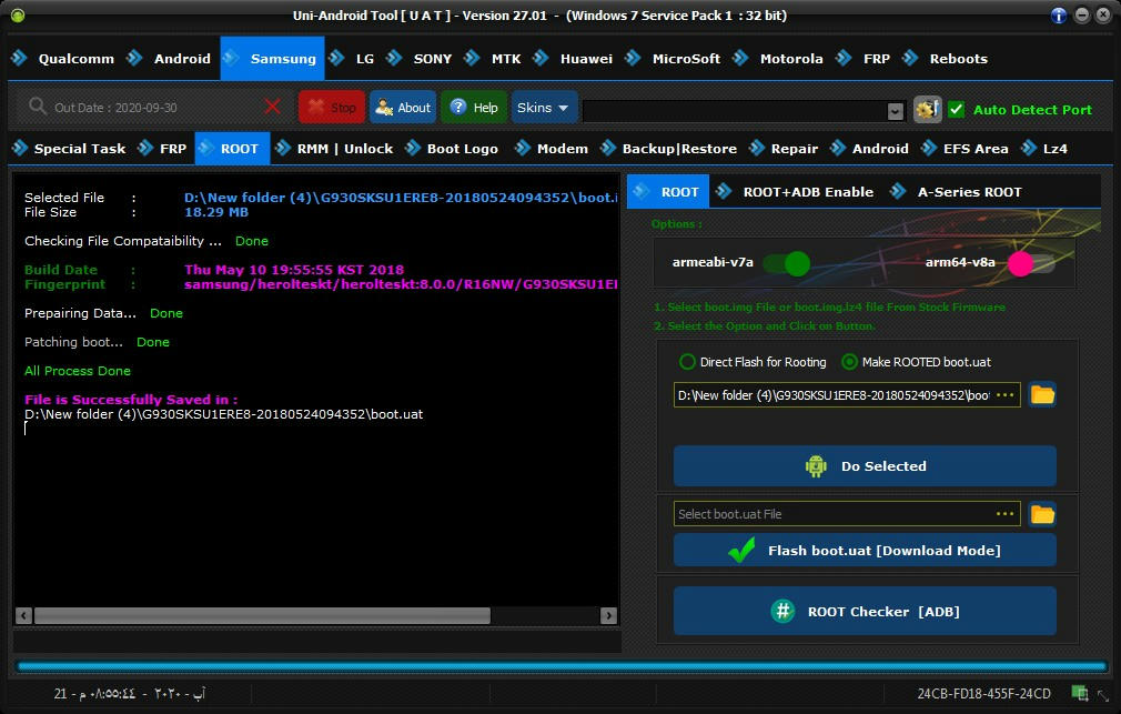

All Process Done

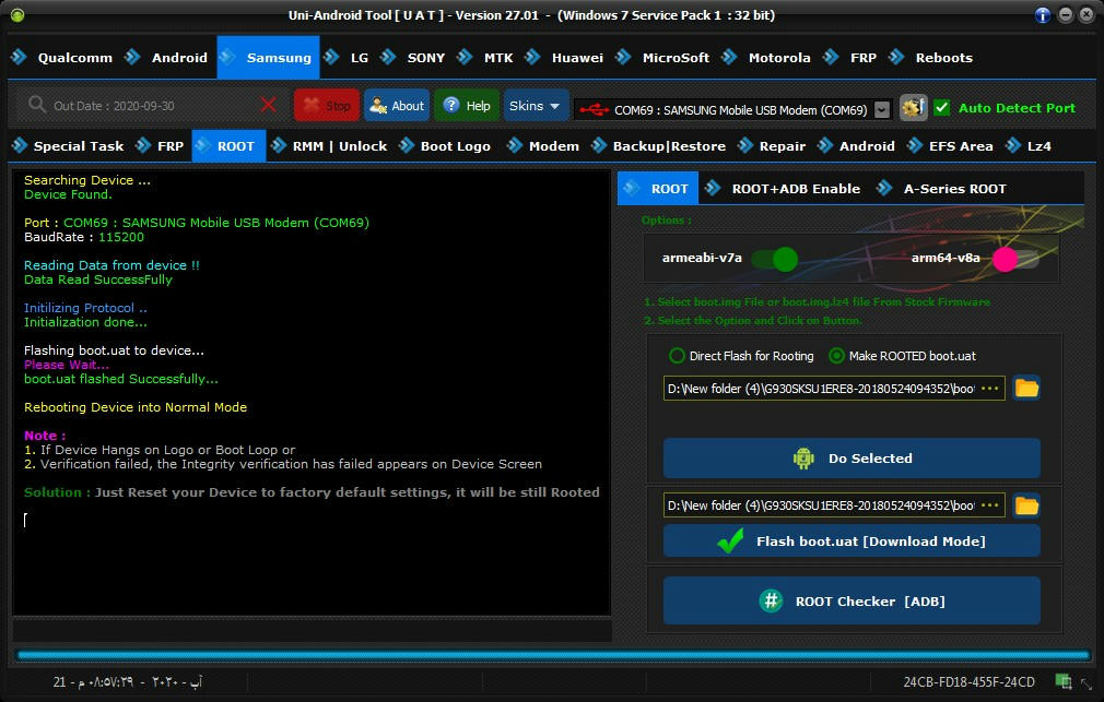

Searching Device ...
Device Found.
Port : COM69 : SAMSUNG Mobile USB Modem (COM69)
BaudRate : 115200
Reading Data from device !!
Data Read SuccessFully
Initilizing Protocol ..
Initialization done...
Flashing boot.uat to device...
Please Wait...
boot.uat flashed Successfully...
Rebooting Device into Normal Mode
Note :
1. If Device Hangs on Logo or Boot Loop or
2. Verification failed, the Integrity verification has failed appears on Device Screen
Solution : Just Reset your Device to factory default settings, it will be still Rooted

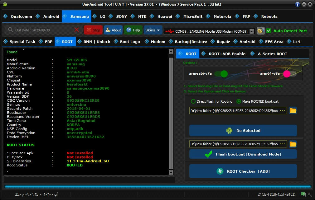

Found
Model : SM-G930S
CPU : arm64-v8a
Warranty bit : 0
Version SDK : 26
Selinux : enforcing
Country : KOREA
Data Encryption : unencrypted
ROOT STATUS
Su Binararies : 11.3:Uni-Android_SU
Root Status : ROOTED
All Process Done
Device Found.
BaudRate : 115200
Please Wait...
Note :
Found
Model : SM-G930S
CPU : arm64-v8a
Warranty bit : 0
Version SDK : 26
Selinux : enforcing
Country : KOREA
ROOT STATUS
