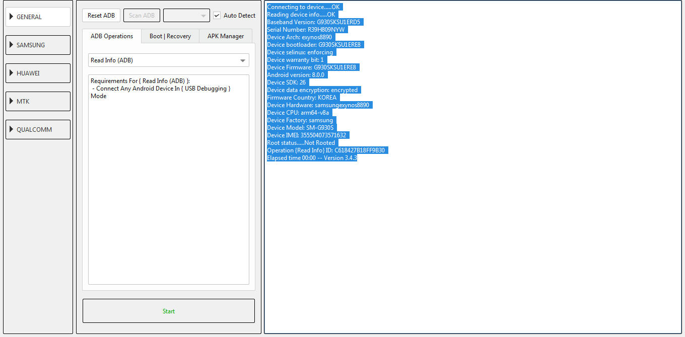

[FONT=&quot]Connecting to device.....OK [/FONT]
[FONT=&quot]Reading device info.....OK [/FONT]
[FONT=&quot]Baseband Version: G930SKSU1ERD5 [/FONT]
[FONT=&quot]Serial Number: R39H809NYW [/FONT]
[FONT=&quot]Device Arch: exynos8890 [/FONT]
[FONT=&quot]Device bootloader: G930SKSU1ERE8 [/FONT]
[FONT=&quot]Device selinux: enforcing [/FONT]
[FONT=&quot]Device warranty bit: 1 [/FONT]
[FONT=&quot]Device Firmware: G930SKSU1ERE8 [/FONT]
[FONT=&quot]Android version: 8.0.0 [/FONT]
[FONT=&quot]Device SDK: 26 [/FONT]
[FONT=&quot]Device data encryption: encrypted [/FONT]
[FONT=&quot]Firmware Country: KOREA [/FONT]
[FONT=&quot]Device Hardware: samsungexynos8890 [/FONT]
[FONT=&quot]Device CPU: arm64-v8a [/FONT]
[FONT=&quot]Device Factory: samsung [/FONT]
[FONT=&quot]Device Model: SM-G930S [/FONT]
[FONT=&quot]Device IMEI: 355504073571632 [/FONT]
[FONT=&quot]Root status.....Not Rooted [/FONT]
[FONT=&quot]Operation {Read Info} ID: C618427B18FF9B30 [/FONT]
[FONT=&quot]Elapsed time 00:00 -- Version 3.4.3[/FONT]

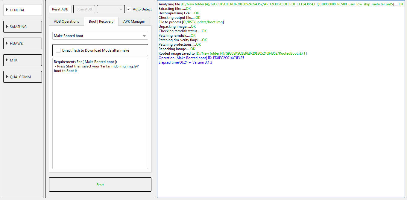

[FONT=&quot]Analyzing file [D:/New folder (4)/G930SKSU1ERE8-20180524094352/AP_G930SKSU1ERE8_CL13438543_QB18088088_REV00_user_low_ship_meta.tar.md5].....OK [/FONT]
[FONT=&quot]Extracting files.....OK [/FONT]
[FONT=&quot]Decompressing LZ4.....OK [/FONT]
[FONT=&quot]Checking output file.....OK [/FONT]
[FONT=&quot]File to process [D:/BST/update/boot.img] [/FONT]
[FONT=&quot]Unpacking image.....OK [/FONT]
[FONT=&quot]Checking ramdisk status.....OK [/FONT]
[FONT=&quot]Patching ramdisk.....OK [/FONT]
[FONT=&quot]Patching dm-verity flags.....OK [/FONT]
[FONT=&quot]Patching protections.....OK [/FONT]
[FONT=&quot]Repacking image.....OK [/FONT]
[FONT=&quot]Rooted image saved to [D:/New folder (4)/G930SKSU1ERE8-20180524094352/RootedBoot.rEFT] [/FONT]
[FONT=&quot]Operation {Make Rooted boot} ID: ED8FC2C014C3E4F5 [/FONT]
[FONT=&quot]Elapsed time 00:24 -- Version 3.4.3[/FONT]

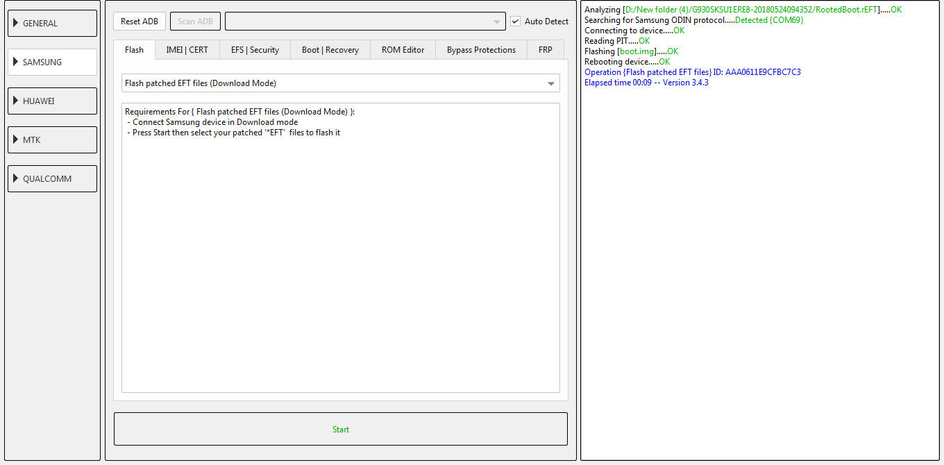

[FONT=&quot]Analyzing [D:/New folder (4)/G930SKSU1ERE8-20180524094352/RootedBoot.rEFT].....OK [/FONT]
[FONT=&quot]Searching for Samsung ODIN protocol.....Detected {COM69} [/FONT]
[FONT=&quot]Reading PIT.....OK [/FONT]
[FONT=&quot]Flashing [boot.img].....OK[/FONT]
[FONT=&quot]Rebooting device.....OK [/FONT]
[FONT=&quot]Operation {Flash patched EFT files} ID: AAA0611E9CFBC7C3 [/FONT]
[FONT=&quot]Elapsed time 00:09 -- Version 3.4.3[/FONT]
[FONT=&quot]Device data encryption: unencrypted [/FONT]
[FONT=&quot]Root status.....Rooted { 3.19:EFTSU } [/FONT]
[FONT=&quot]Operation {Read Info} ID: 0E9DB6064DB4FB27 [/FONT]
