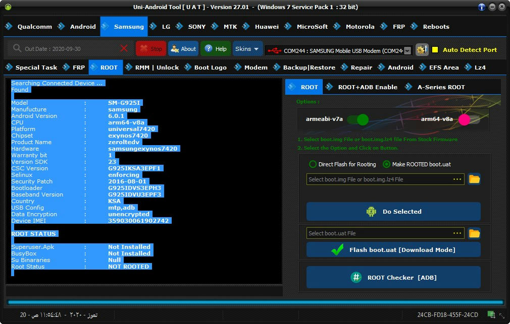

Searching Connected Device ...
Found
Model : SM-G925I
Manufucture : samsung
Android Version : 6.0.1
CPU : arm64-v8a
Platform : universal7420
Chipset : exynos7420
Product Name : zeroltedv
Hardware : samsungexynos7420
Warranty bit : 1
Version SDK : 23
CSC Version : G925IKSA3EPF1
Selinux : enforcing
Security Patch : 2016-08-01
Bootloader : G925IDVS3EPH3
Baseband Version : G925IDVU3EPF3
Country : KSA
USB Config : mtp,adb
Data Encryption : unencrypted
Device IMEI : 359030061902742
ROOT STATUS
Superuser.Apk : Not Installed
BusyBox : Not Installed
Su Binararies : Null
Root Status : NOT ROOTED

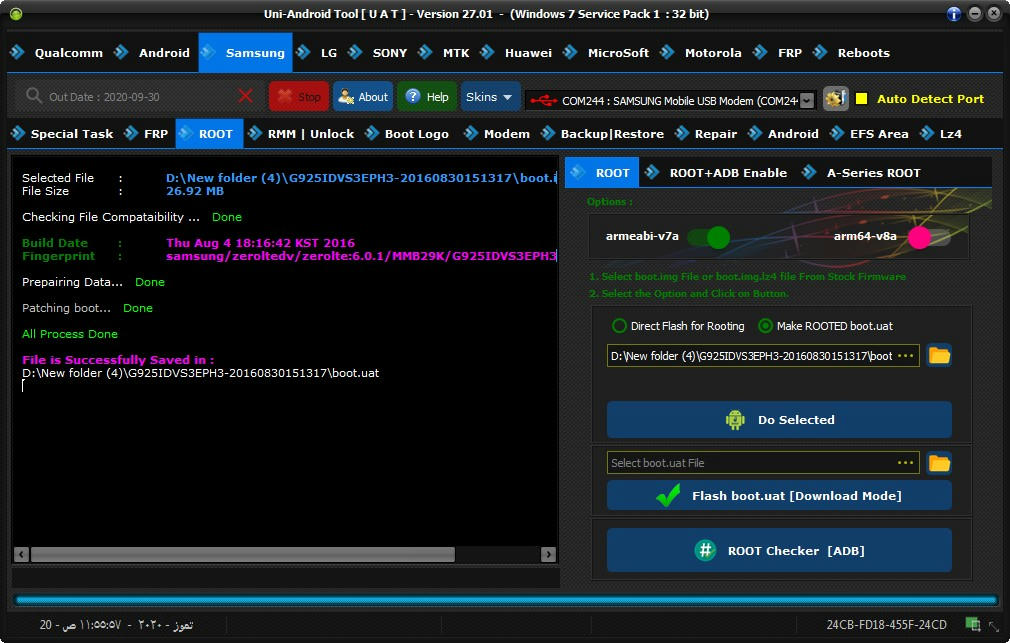

Selected File : D:\New folder (4)\G925IDVS3EPH3-20160830151317\boot.img
File Size : 26.92 MB
Checking File Compataibility ... Done
Build Date : Thu Aug 4 18:16:42 KST 2016
Fingerprint : samsung/zeroltedv/zerolte:6.0.1/MMB29K/G925IDVS3EPH3:user/test-keys
Prepairing Data... Done
Patching boot... Done
All Process Done
File is Successfully Saved in :
D:\New folder (4)\G925IDVS3EPH3-20160830151317\boot.uat

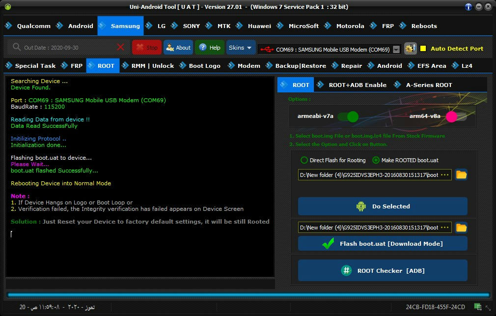

Searching Device ...
Device Found.
Port : COM69 : SAMSUNG Mobile USB Modem (COM69)
BaudRate : 115200
Reading Data from device !!
Data Read SuccessFully
Initilizing Protocol ..
Initialization done...
Flashing boot.uat to device...
Please Wait...
boot.uat flashed Successfully...
Rebooting Device into Normal Mode
Note :
1. If Device Hangs on Logo or Boot Loop or
2. Verification failed, the Integrity verification has failed appears on Device Screen
Solution : Just Reset your Device to factory default settings, it will be still Rooted

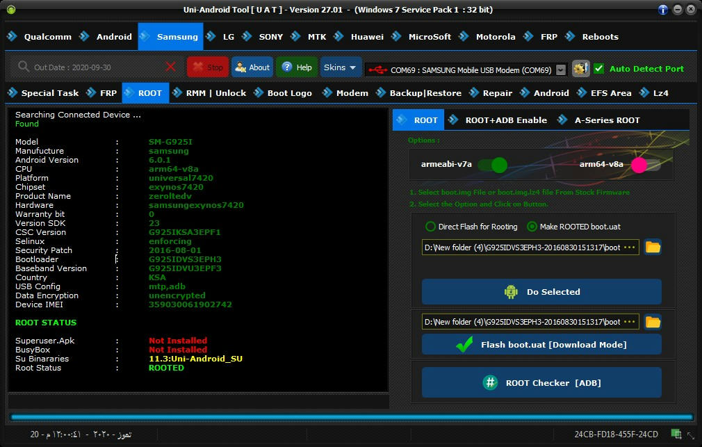

Found
Model : SM-G925I
CPU : arm64-v8a
Warranty bit : 0
Version SDK : 23
Selinux : enforcing
Country : KSA
ROOT STATUS
Su Binararies : 11.3:Uni-Android_SU
Root Status : ROOTED
