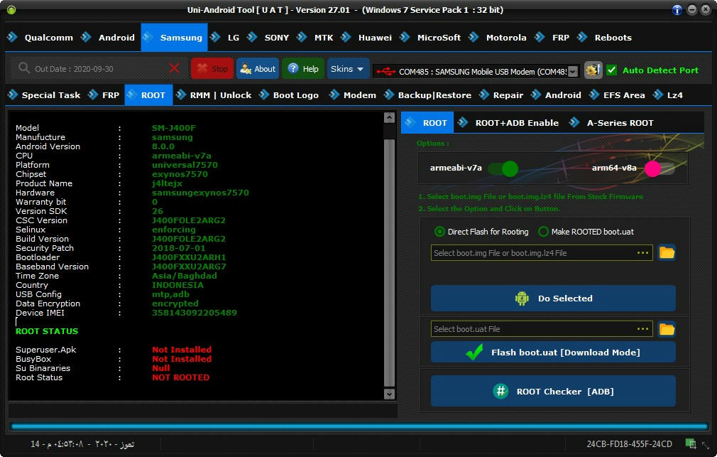

Searching Connected Device ...
Found
Model : SM-J400F
Manufucture : samsung
Android Version : 8.0.0
CPU : armeabi-v7a
Platform : universal7570
Chipset : exynos7570
Product Name : j4ltejx
Hardware : samsungexynos7570
Warranty bit : 0
Version SDK : 26
CSC Version : J400FOLE2ARG2
Selinux : enforcing
Build Version : J400FOLE2ARG2
Security Patch : 2018-07-01
Bootloader : J400FXXU2ARH1
Baseband Version : J400FXXU2ARG7
Time Zone : Asia/Baghdad
Country : INDONESIA
USB Config : mtp,adb
Data Encryption : encrypted
Device IMEI : 358143092205489
ROOT STATUS
Superuser.Apk : Not Installed
BusyBox : Not Installed
Su Binararies : Null
Root Status : NOT ROOTED

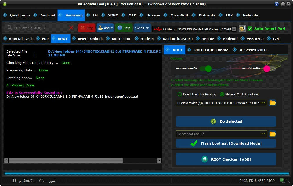

Selected File : D:\New folder (4)\J400FXXU2ARH1 8.0 FIRMWARE 4 FILES Indonesien\boot.img.lz4
File Size : 11.98 MB
Checking File Compataibility ... Done
Prepairing Data... Done
Patching boot... Done
All Process Done
File is Successfully Saved in :
D:\New folder (4)\J400FXXU2ARH1 8.0 FIRMWARE 4 FILES Indonesien\boot.uat

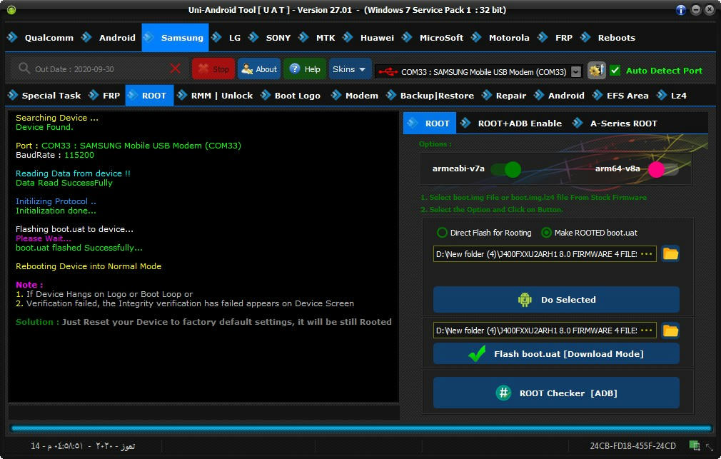

Searching Device ...
Device Found.
Port : COM33 : SAMSUNG Mobile USB Modem (COM33)
BaudRate : 115200
Reading Data from device !!
Data Read SuccessFully
Initilizing Protocol ..
Initialization done...
Flashing boot.uat to device...
Please Wait...
boot.uat flashed Successfully...
Rebooting Device into Normal Mode
Note :
1. If Device Hangs on Logo or Boot Loop or
2. Verification failed, the Integrity verification has failed appears on Device Screen
Solution : Just Reset your Device to factory default settings, it will be still Rooted

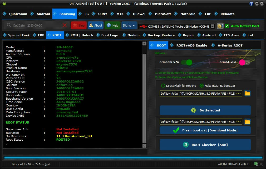

device unauthorized. Please check the confirmation dialog on your device
Found
Model : SM-J400F
CPU : armeabi-v7a
Warranty bit : 0
Version SDK : 26
Selinux : enforcing
Country : INDONESIA
Data Encryption : unencrypted
ROOT STATUS
Su Binararies : 11.3:Uni-Android_SU
Root Status : ROOTED
