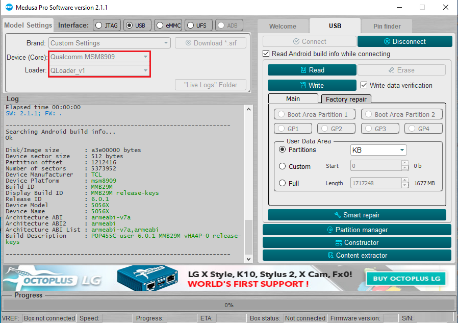

Welcome to Medusa Pro Software version 2.1.1.
Started.
Reader #0: Alcor Micro USB Smart Card Reader 0
Model Settings:
Interface : USB
Core      : Qualcomm MSM8909
Loader    : QLoader_v1
Connecting...
Sending loader...OK.
Loader successfully initialized.
Device       : CoreID_009600E1
Page size    : 512 B
Block size   : 512 B
Block count  : 30535680
Size         : 14.56 GB (14910.00 MB)
Connect successful.
SW: 2.1.1; FW: .
P00: GPT              (00000000, 00008000)    16 MB
P01: modem            (00008000, 00020000)    64 MB
P02: sbl1             (00028000, 00000400)    512 KB
P03: sbl1bk           (00028400, 00000400)    512 KB
P04: DDR              (00028800, 00000040)    32 KB
P05: aboot            (00028840, 00000800)    1024 KB
P06: abootbk          (00029040, 00000800)    1024 KB
P07: rpm              (00029840, 00000400)    512 KB
P08: rpmbk            (00029C40, 00000400)    512 KB
P09: tz               (0002A040, 00000800)    1024 KB
P10: tzbk             (0002A840, 00000800)    1024 KB
P11: boot             (0002B040, 00010000)    32 MB
P12: modemst1         (00040000, 00000C00)    1536 KB
P13: modemst2         (00040C00, 00000C00)    1536 KB
P14: fsg              (00041800, 00000C00)    1536 KB
P15: sec              (00042400, 00000020)    16 KB
P16: fsc              (00042420, 00000002)    1024 b
P17: ssd              (00042422, 00000010)    8 KB
P18: tunning          (00042432, 00000C00)    1536 KB
P19: traceability     (00043032, 00000010)    8 KB
P20: binary           (00043042, 00000800)    1024 KB
P21: mobile_info      (00043842, 00010000)    32 MB
P22: expd             (00053842, 00004000)    8 MB
P23: splash           (00057842, 00001800)    3072 KB
P24: keystore         (00059042, 00000400)    512 KB
P25: simlock          (00059442, 00000800)    1024 KB
P26: reserved         (00059C42, 0000A000)    20 MB
P27: oem              (00063C42, 00020000)    64 MB
P28: misc             (00083C42, 00000800)    1024 KB
P29: cache            (00084442, 00083000)    262 MB
P30: persist          (00107442, 00010000)    32 MB
P31: tct_persist      (00117442, 00010000)    32 MB
P32: system           (00128000, 00520000)    2624 MB
P33: recovery         (00648000, 00007800)    15 MB
P34: pad              (0064F800, 00000800)    1024 KB
P35: config           (00650000, 00000400)    512 KB
P36: devinfo          (00650400, 00000800)    1024 KB
P37: userdata         (00650C00, 016CE3DF)    11.4 GB
Backuping modemst1 partition...
Opening C:/Program Files (x86)/Medusa Pro Software/Backups/_modemst1_0x40000_0xc00_12_07_2020_08_38_11.bin file...
Reading. Please wait... Done.
Elapsed time 00:00:00
SW: 2.1.1; FW: .
Backuping modemst2 partition...
Opening C:/Program Files (x86)/Medusa Pro Software/Backups/_modemst2_0x40c00_0xc00_12_07_2020_08_38_11.bin file...
SW: 2.1.1; FW: .
Backuping fsg partition...
Opening C:/Program Files (x86)/Medusa Pro Software/Backups/_fsg_0x41800_0xc00_12_07_2020_08_38_11.bin file...
SW: 2.1.1; FW: .
---------------------------------------------------------------Searching Android build info...
Ok
Disk/Image size       : a3e00000 bytes
Device sector size    : 512 bytes
Partition offset      : 1212416
Number of sectors     : 5373952
Device Manufacturer   : TCL
Device Platform       : msm8909
Build ID              : MMB29M
Display Build ID      : MMB29M release-keys
Release ID            : 6.0.1
Device Model          : 5056X
Device Name           : 5056X
Architecture ABI      : armeabi-v7a
Architecture ABI2     : armeabi
Architecture ABI List : armeabi-v7a,armeabi
Build Description     : POP455C-user 6.0.1 MMB29M vHA4P-0 release-keys

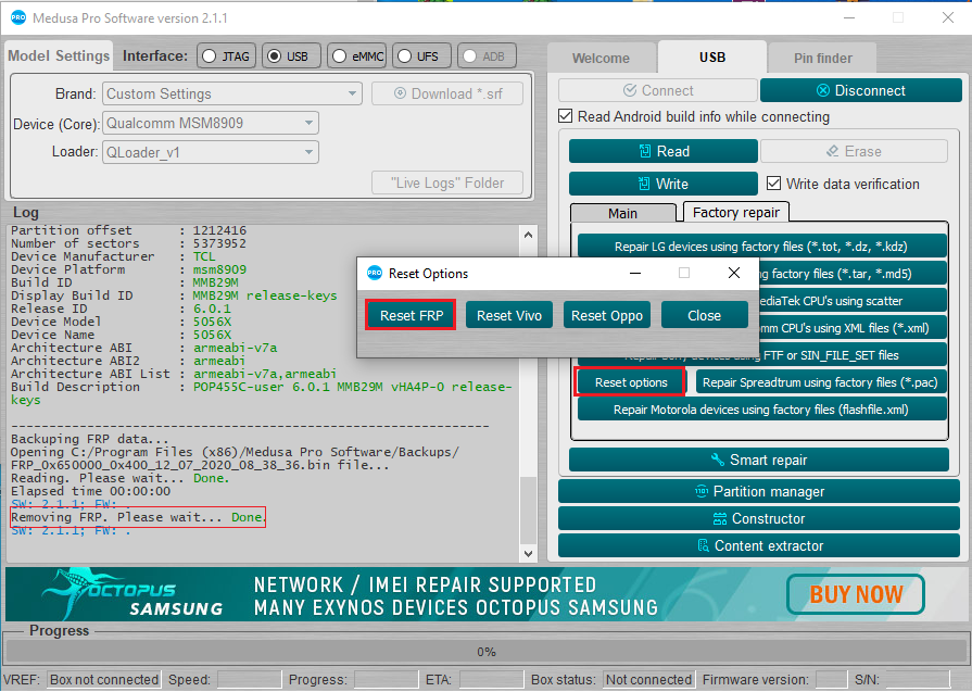

---------------------------------------------------------------Backuping FRP data...
Opening C:/Program Files (x86)/Medusa Pro Software/Backups/FRP_0x650000_0x400_12_07_2020_08_38_36.bin file...
SW: 2.1.1; FW: .
Removing FRP. Please wait... Done.
SW: 2.1.1; FW: .
