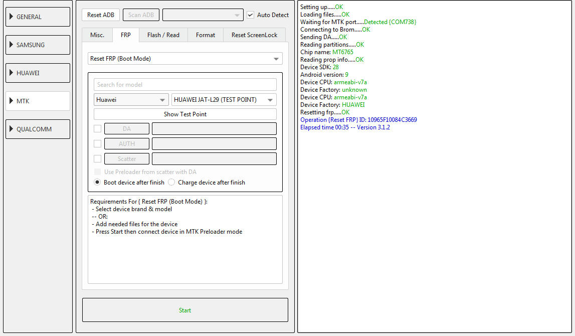

ازالة قفل FRP لهاتف Huawei Y6s (2019) JAT-L29 بالتيست بوينت
4,650
8,309
Setting up.....OK
Loading files.....OK
Waiting for MTK port.....Detected {COM738}
Connecting to Brom.....OK
Sending DA.....OK
Reading partitions.....OK
Chip name: MT6765
Reading prop info.....OK
Device SDK: 28
Android version: 9
Device CPU: armeabi-v7a
Device Factory: unknown
Device Factory: HUAWEI
Resetting frp.....OK
Operation {Reset FRP} ID: 10965F10084C3669
Elapsed time 00:35 -- Version 3.1.2
