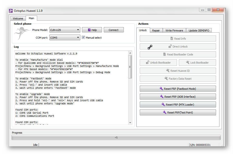

Welcome to Octoplus Huawei Software v.‪1.1.9‬
To enable 'Manufacture' mode dial
- for Qualcomm and Hisilicon based models: *#*#2846579#*#*
ProjectMenu > Background Settings > USB Port Settings > Manufacture Mode
- for MTK based models: *#*#14789632#*#*
ProjectMenu > Background Settings > USB Port Settings > Debug Mode
To enable 'Fastboot' mode
1. Power off the phone. Remove SD and SIM cards
2. Press 'Vol-' and insert USB cable
3. Wait until phone enters 'Fastboot' mode
To enable 'Upgrade' mode
2. Press and hold 'Vol-' and 'Vol+' keys and insert USB cable
3. Wait until phone enters 'Upgrade mode'
Found COM ports:
1: COM5 USB Serial Port
2: COM1 Communications Port
Found COM ports:
2020-06-11 08:16:48 GMT -------------------------------------------------
Starting Reset FRP (MTK Loader)
Please Power off the phone and insert USB cable
Detecting Chip Version...
HW Chip : MT6582
HW Version : 8A00.CA01.0001.0000
Brom Version: FF
Boot Loader Version: 01
Sending Download Agent...
DA successfully sent
Synchronizing with DA...
NAND Flash: not installed
eMMC Flash: 90014A48.38473165.507586A.AD943485
eMMC Flash: Hynix: H8G1e
DA ver : 4.2.87
Initializing Memory Flash...
Initialization completed
Sending Loader...
Loader successfully sent
Reading Flash Info...
EMMC rpmb size : 4 Mb
EMMC boot1 size : 4 Mb
EMMC boot2 size : 4 Mb
EMMC gp1 size : 0 Mb
EMMC gp2 size : 0 Mb
EMMC gp3 size : 0 Mb
EMMC gp4 size : 0 Mb
EMMC user area size : 7456 Mb
Internal RAM size : 128 Kb
External RAM size : 1024 Mb
Reading Partition Table
Reading FRP Partition
Writing FRP Partition data
Reset FRP (MTK Loader) done.
Performed by ‪1.1.9‬ Software version.
