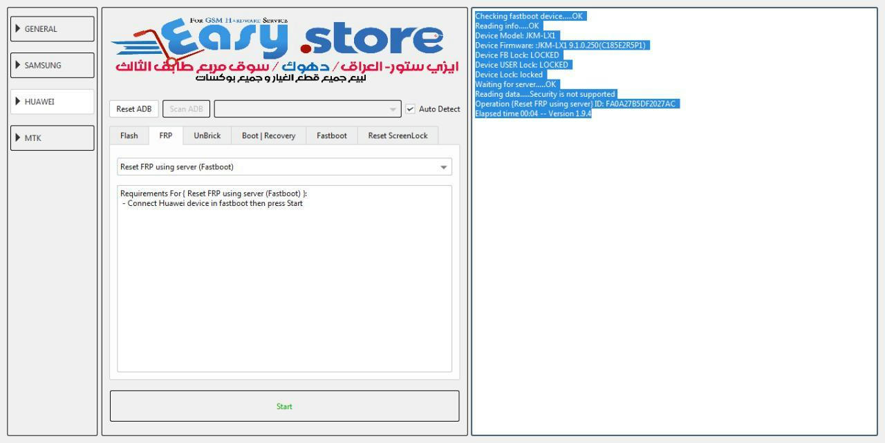

معلومات الهاتف

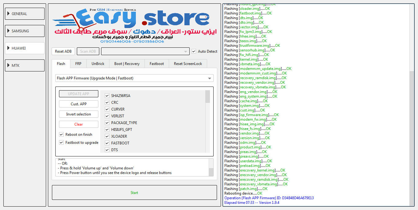

عمليه ال downgrade
السجل
Checking fastboot device.....OK Reading info.....OK
Device Model: JKM-LX1
Device Firmware: :JKM-LX1 9.1.0.250(C185E2R5P1)
Device FB Lock: LOCKED
Device USER Lock: LOCKED
Device Lock: locked
Checking needed files.....OK
Writing image 1.....OK
Writing image 2.....OK
Writing image 3.....OK
Switching to upgrade mode.....1OK
Connecting to device.....OK
Start processing file [UPDATE.APP] 3,42 GB:
Firmware version: JKM 9.0.1(OVS)
Flashing [crc.img].....OK
Flashing [curver.img].....OK
Flashing [verlist.img].....OK
Flashing [xloader.img].....OK
Flashing [dts.img].....OK
Flashing [dto.img].....OK
Flashing [vector.img].....OK
Flashing [fw_lpm3.img].....OK
Flashing [hhee.img].....OK
Flashing [teeos.img].....OK
Flashing [fw_hifi.img].....OK
Flashing [kernel.img].....OK
Flashing [vbmeta.img].....OK
Flashing [cache.img].....OK
Flashing [system.img].....OK
Flashing [cust.img].....OK
Flashing [vendor.img].....OK
Flashing [version.img].....OK
Flashing [odm.img].....OK
Flashing [product.img].....OK
Flashing [preas.img].....OK
Flashing [preavs.img].....OK
Flashing [preload.img].....OK
Flashing [patch.img].....OK
Rebooting device.....OK
Operation {Flash APP Firmware} ID: D34B48D46A679E13
Elapsed time 07:33 -- Version 1.9.4

الفلاشة المستعملة : Jackman-L21 9.1.0.220(C185E1R5P1T8)
