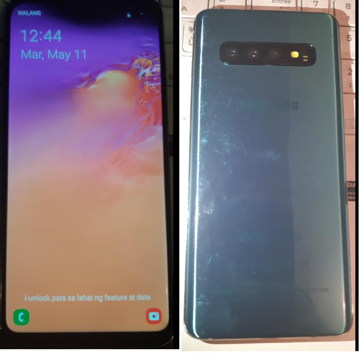

اقدم لكم اعاء و زوار المنتدى فلاشة سامسونج G970F> S10> صيني مسحوبة بدونجل EMMC
الهاتف:

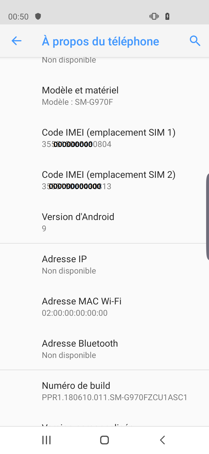

من الاعدادات:

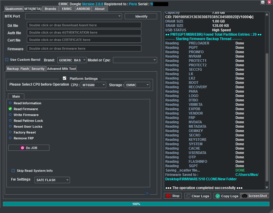

انفو السحب:
Checking Operation Type DONEChecking send bootloader method AUTO
????? waiting for mtk device connection ??????
????? Sending Download Agent to device ??????
????? The Download Agent successfully Loaded ??????
ChipName MT6580
????????? Detected EMMC Storage Type ???????
eMMC BOOT1 4096.0 KB
eMMC BOOT2 4096.0 KB
eMMC RPMB 4096.0 KB
eMMC USER 7.04 GB
Capacity 7.05 GB
CID: 7001005631303030870385C0458B92D[V1000?]
DRAM SIZE 1.00 GB
SRAM SIZE 128.00 KB
USB STATUS High Speed
?? PMT(GPT/MBR/EBR) Found Total Partition Entries : 29 ??
-------- Starting Firmware Backup Thread --------
Reading PRELOADER Done
Reading PGPT Done
Reading PROINFO Done
Reading NVRAM Done
Reading PROTECT1 Done
Reading PROTECT2 Done
Reading SECCFG Done
Reading LK Done
Reading LK2 Done
Reading BOOT Done
Reading RECOVERY Done
Reading PARA Done
Reading LOGO Done
Reading DTBO Done
Reading VBMETA Done
Reading EXPDB Done
Reading VENDOR Done
Reading FRP Done
Reading NVDATA Done
Reading METADATA Done
Reading OEMKEY Done
Reading SECRO Done
Reading KEYSTORE Done
Reading SYSTEM Done
Reading CACHE Done
Reading USERDATA Done
Reading OTP Done
Reading FLASHINFO Done
Reading SGPT Done
Saving _scatter file... DONE
Firmware Saved to : C:/Users/Mus/Desktop/FIRMWARE/S10 CLONE/New Folder
??? The operation completed successfully ???
