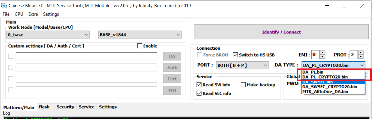

جرب
da_pl_xxxxx
base 1712,1844
جرب
da_pl_m2
https://www.sendspace.com/file/0p7plc
