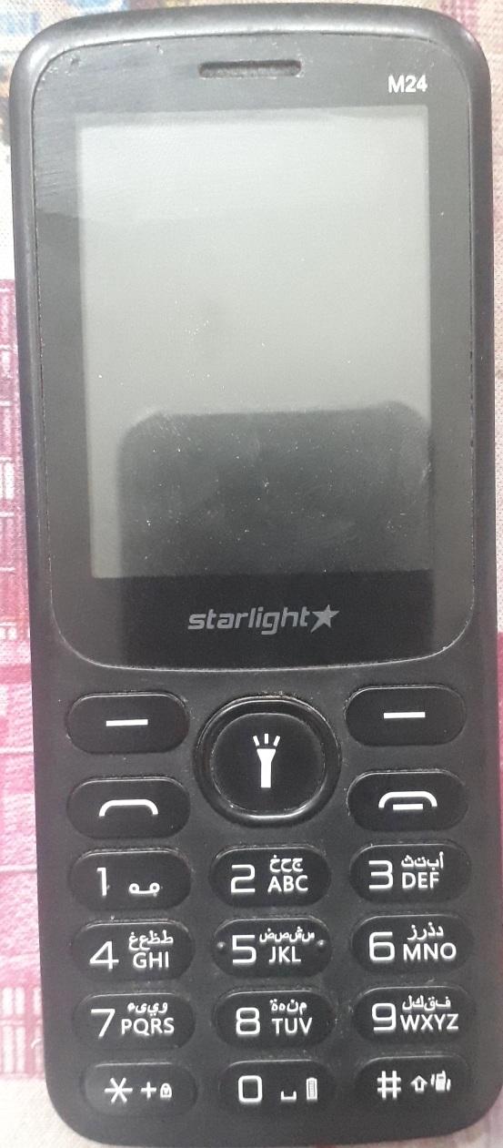

Starlight M24
.:: Sebti _ Gsm ::.
:: مراقب قسم بوكسات الجيتاق JTAG ::
30 ديسمبر 2015
1,779
3,312
Ghardaïa
اقدم لكم فلاشة: Starlight M24 مسحوبة بــ InfinityBox

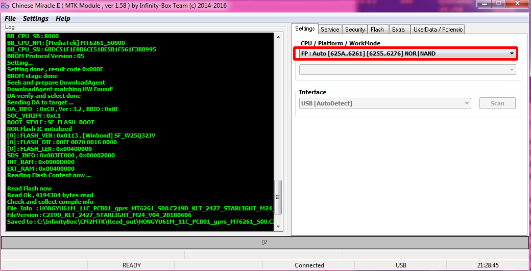

طريقة التبويت:
1-نزع البطارية من الهاتف
2-توصيل الكابل USB بالهاتف تم تركيب البطارية
[LEFT]Operation : Check / Read Info [ v1.58 ]
2. Insert USB cable. In some cases require hold BootKey ( '*' )
Wait for phone...
Phone found! [ 101 ]
Sync...
Sync Ok, read regs...
Inital regs read done
Boot Info :
BB_CPU_ID : 6261
BB_CPU_HW : CB01
BB_CPU_SW : 0001
BB_CPU_SB : 8000
BB_CPU_NM : [MediaTek] MT6261_S0000
BB_CPU_SN : 6BDC51F1E8B6CE51BE5B1F561F3BB995
BROM Protocol Version : 05
Setting...
Setting done , result code 0x000E
BROM stage done
Seek and prepare DownloadAgent
DownloadAgent matching HW Found!
DA verify and select done
Sending DA to target ...
DA_INFO   : 0xC0 , Ver : 3.2 , BBID : 0x8E
SOC_VERIFY : 0xC1
BOOT_STYLE : SF_FLASH_BOOT
NOR Flash IC initialized
[0] : FLASH_VEN : 0x0113 , [Winbond] SF_W25Q32JV
[0] : FLASH_DIE : 00EF 0070 0016 0000
[0] : FLASH_LEN : 0x00400000
SDS_INFO : 0x003FE000 , 0x00002000
INT_RAM : 0x0000D000
EXT_RAM : 0x00400000
File_Info   : HONGYU61M_11C_PCB01_gprs_MT6261_S00.C219D_KLT_2427_STARLIGHT_M24_V04_20180606.bin
FileVersion : C219D_KLT_2427_STARLIGHT_M24_V04_20180606
Done!
Elapsed: 00:00:07
Reconnect Power/Cable!
Operation : Read Flash [ v1.58 ]
Wait for phone...
Sync...
Boot Info :
BB_CPU_ID : 6261
BB_CPU_HW : CB01
BB_CPU_SW : 0001
BB_CPU_SB : 8000
Setting...
BROM stage done
SOC_VERIFY : 0xC1
Reading Flash Content now ...
Read Flash now
Read Ok , 4194304 bytes read
Check and collect compile info
Saved to : C:\InfinityBox\CM2MTK\Read_out\HONGYU61M_11C_PCB01_gprs_MT6261_S00.C219D_KLT_2427_STARLIGHT_M24_V04_20180606.bin
Done!
Elapsed: 00:00:23
Reconnect Power/Cable![/LEFT]
