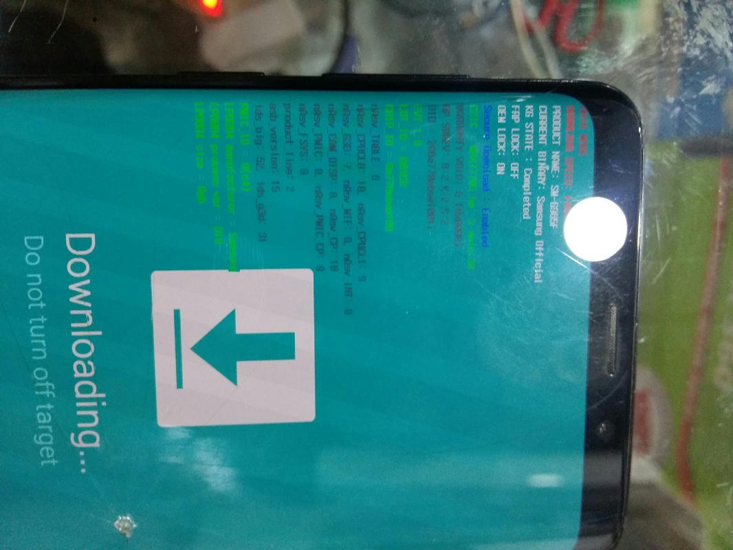

ازالة حماية KNOX GUARD KG STATE PRENORMAL لهاتف Samsung Galaxy S9+ SM-G965F النظام 9.
الحالة
4,646
8,308
g965f_prenormal

Chimera Mobile Phone Utility version: 21.25.1302 @ 2019-05-29
Printing phone history
Get Info
29/05/2019
06:39:14
م
Knox Guard Unlock started
Gathering phone info...
Collecting information. Be patient! Do NOT disconnect the phone!
Model: SM-G965F
Sales Code: MID
Country Code: Iraq
Timezone: Asia/Baghdad
Android Version: 9 [PPR1.180610.011] [SDK 28]
Build Date: Fri Mar 15 09:56:36 KST 2019
PDA Version: G965FXXU2CSCB [march 2019, revB]
Phone Version: G965FXXU2CSC1 [march 2019, rev1]
CSC Version: G965FOXM2CSCD [march 2019, revD]
Product Code: MID
HIDSw Version: G965FXXU2CSCB/G965FOXM2CSCD/G965FXXU2CSC1/G965FXXU2CSCB
Board Platform: EXYNOS5
Modem Platform: SHANNON360
Serial Number: R58KA40HC6A
Imei: 355220095736752
Unique Number: CE071827CCA1A9C81C7E
Connections: AT,MTP
Battery Status: 3.86V (43%)
Network Type: GSM
SIM Status: ABSENT,ABSENT
Multisim Config: DSDS
Knox Version: v30
Warranty Bit: 0
Security Patch: 2019-03-01
Data Encryption State: encrypted
Unlocking KnoxGuard...
The operation is in progress. Be patient! Do NOT disconnect the phone!
Current state: Prenormal
New state: Completed
Succeeded!
Successfully finished.
Finished at local time: [05.29.19 21:39:57]
WorkID: 61133949
