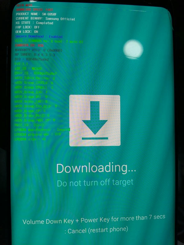

ازالة حماية KNOX GUARD KG STATE PRENORMAL لهاتف Samsung Galaxy S8 G950FD النظام 9.0 ا

Knox Guard Unlock started
Gathering phone info...
Collecting information. Be patient! Do NOT disconnect the phone!
Model: SM-G950F
Sales Code: XSG
Country Code: UAE
Timezone: Asia/Baghdad
Android Version: 9 [PPR1.180610.011] [SDK 28]
Build Date: Mon Apr 8 14:11:20 KST 2019
PDA Version: G950FXXS4DSD3 [april 2019, rev3]
Phone Version: G950FXXS4DSD3 [april 2019, rev3]
CSC Version: G950FOXM4DSBA [february 2019, revA]
Board Platform: EXYNOS5
Modem Platform: SHANNON355
Serial Number: RF8JA2DRB9L
Imei: 359623085710412
Battery Status: 4.01V (70%)
Network Type: GSM
SIM Status: ABSENT,ABSENT
Multisim Config: DSDS
Knox Version: v30
Warranty Bit: 0
Security Patch: 2019-04-01
Data Encryption State: encrypted
Unlocking KnoxGuard...
The operation is in progress. Be patient! Do NOT disconnect the phone!
Current state: Prenormal
New state: Completed
Succeeded!
Successfully finished.
Finished at local time: [05.24.19 21:55:27]
WorkID: 60626077
