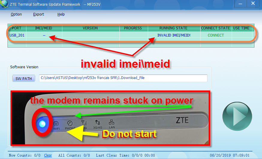

zte mf253v does not boot
do not accept the update
remains stuck on power
