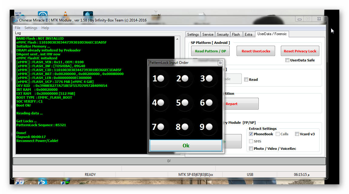

ازالة قفل النمط لجهاز Gt-i8262 mt6572

Operation : Read Pattern/DP Lock [ v1.58 ]
2. Insert USB cable. In some cases require hold BootKey
Wait for phone...
Phone found! [ 49 ]
Sync...
Inital Boot Ok!
BB_CPU_PID : 6572
BB_CPU_NME : [MediaTek] MT6572_S00
BB_CPU_EXT : 0xCA01 , 0x8A00 , 0x0000
Processing BROM stage
Settings for BROM configured!
SecCfgVal : 0x00000000
BromVer : 0x00FF
BLVersion : 0x0001
Processing DA stage
Sending and initialize DA ...
Running DA ver.4.2 on BBID : 0x88
NAND Flash : NOT INSTALLED
eMMC Flash : 11010030303447393010D366EC1EA05F
Initialize Memory ...
DAgent sent , init HW now
eMMC FlashIC initialized
[eMMC] : FLASH_VEN : 0x11 , OEM : 0100
[eMMC] : FLASH_INF : [TOSHIBA] , 09G40
[eMMC] : FLASH_CID : 11010030303447393010D366EC1EA05F
[eMMC] : FLASH_BRT : 0x00200000 , 0x00200000 , 0x00080000
[eMMC] : FLASH_LEN : 0x00000000EC000000
[eMMC] : FLASH_UCP : 3776 MiB [eMMC 4 GiB]
DEV RID : 0x3988EB277A75BE5F557D70972B409054
INT RAM : 0x00020000
EXT RAM : 0x20000000 [512 MiB]
BOOT TYPE : EMMC_FLASH_BOOT
SOC VERIFY : C1
Boot Ok!
Reading data ...
Get Locks ...
PatternLock Sequnce : 85321
Done!
Elapsed: 00:00:17
Reconnect Power/Cable!
