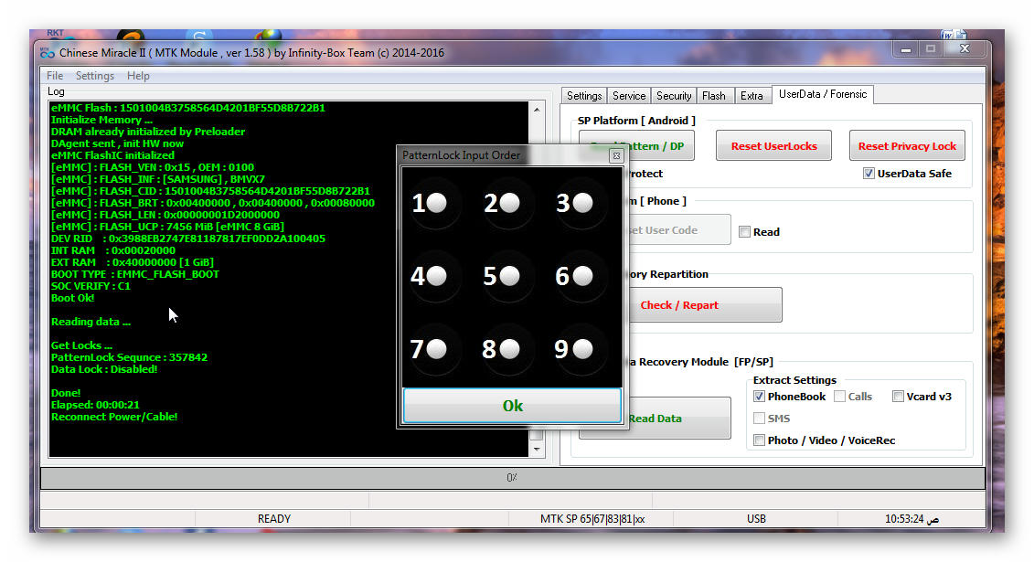

السلام عليكم فقط وصل الهاتف وهو مطفئ
Samsung Galaxy Note 8 Duos SM-N9500 MT6580
Brand : alps
ProdName : full_gxq6580_weg_l
ProdModel : gxq6580_weg_l
Device : gxq6580_weg_l
AndroidVer: 5.1
MTKxCPU : MT6580
MTKxPRJ : ALPS.L1.MP6.V2_GXQ6580.WEG.L_P69
Quote:
Wait for phone...
Phone found! [ 107 ]
Sync...
Inital Boot Ok!
BB_CPU_PID : 6580
BB_CPU_NME : [MediaTek] MT6580_S00
BB_CPU_EXT : 0xCA00 , 0x8A00 , 0x0000
Processing BROM stage
Settings for BROM configured!
SecCfgVal : 0x00000000
BromVer : 0x00FF
BLVersion : 0x0001
Processing DA stage
Sending and initialize DA ...
Running DA ver.4.2 on BBID : 0x94
NAND Flash : NOT INSTALLED
eMMC Flash : 1501004B3758564D4201BF55D8B722B1
Initialize Memory ...
DAgent sent , init HW now
eMMC FlashIC initialized
[eMMC] : FLASH_VEN : 0x15 , OEM : 0100
[eMMC] : FLASH_INF : [SAMSUNG] , BMVX7
[eMMC] : FLASH_CID : 1501004B3758564D4201BF55D8B722B1
[eMMC] : FLASH_BRT : 0x00400000 , 0x00400000 , 0x00080000
[eMMC] : FLASH_LEN : 0x00000001D2000000
[eMMC] : FLASH_UCP : 7456 MiB [eMMC 8 GiB]
DEV RID : 0x3988EB2747E81187817EF0DD2A100405
INT RAM : 0x00020000
EXT RAM : 0x40000000 [1 GiB]
BOOT TYPE : EMMC_FLASH_BOOT
SOC VERIFY : C1
Boot Ok!
[AP] : Initial info read Ok!
Brand : alps
AndroidVer: 5.1
MTKxCPU : MT6580
SECURITY :
IMEI_SW [1] : 358352149213376
IMEI_SW [2] : 358352149213384
BTMAC Addr : 3629466580E0
WiFi MAC : 000000000000
MODEM :
BaseBand : MT6580_S00_MOLY_WR8_W1449_MD_WG_MP_V6_P6_1_wg_n
EXTRA :
LCD : Not info available
LCD Res : 1080x540
TOUCH [0] : GT1XX
CAM [0] : STOM_HAL_IMGSENSOR
CAM [1] : =bf2206mipi_raw
CAM [2] : bf2206main_mipi_raw
CAM [3] : sp2509_mipi_raw
CAM [4] : sp2509main_mipi_raw
CAM [5] : gc8024mipi_raw
CAM [6] : a5142_mipi_raw
CAM [7] : ov5675_mipi_raw
CAM [8] : ov5675_sub_mipi_raw
CAM [9] : gc2385_mipi_raw
CAM [10] : gc2385main_mipi_raw
CAM [11] : gc5024_mipi_raw
CAM [12] : imx219_mipi_raw
CAM [13] : gc2365mipi_raw
CAM [14] : gc5005mipi_raw
CAM [15] : gc2365main_mipi_raw
CAM [16] : mn045_mipi_raw
CAM [17] : ov5693_mipi_raw
CAM [18] : sp540a_mipi_raw
CAM [19] : s5k4h8_mipi_raw
CAM [20] : ov509_mipi_raw
CAM [21] : sp8408_mipi_raw
CAM [22] : imx239_mipi_raw
CAM [23] : sp250a_main_mipi_raw
CAM [24] : sp250a_mipi_raw
CAM [25] : gc2375mipi_raw
CAM [26] : ov8856_mipi_raw
CAM [27] : hi556_mipi_raw
CAM [28] : hi556_sub_mipi_raw
CAM [29] : gc5025mipi_raw
CAM [30] : s5k3m2_mipi_raw
CAM [31] : s5k3h7yx_mipi_raw
CAM [32] : ov8865_mipi_raw
MODEM : Z6U230_band_1_2_5_8
LOCALE : zh_CN es_ES en_US zh_TW pt_BR ru_RU fr_FR de_DE tr_TR vi_VN ms_MY in_ID th_TH it_IT ar_EG hi_IN bn_IN ur_PK fa_IR pt_PT nl_NL el_GR hu_HU tl_PH ro_RO cs_CZ ko_KR km_KH iw_IL pl_PL es_US bg_BG hr_HR lv_LV lt_LT sk_SK uk_UA de_AT da_DK fi_FI nb_NO sv_SE en_GB hy_AM et_EE ja_JP kk_KZ sr_RS sl_SI ca_ES my_ZG
Done!
Elapsed: 00:00:10
Reconnect Power/Cable!
Operation : Read Pattern/DP Lock [ v1.58 ]
2. Insert USB cable. In some cases require hold BootKey
Wait for phone...
Sync...
Inital Boot Ok!
BB_CPU_PID : 6580
BromVer : 0x00FF
BLVersion : 0x0001
Processing DA stage
SOC VERIFY : C1
Boot Ok!
Reading data ...
Get Locks ...
PatternLock Sequnce : 357842
Data Lock : Disabled!
Done!
Elapsed: 00:00:21
