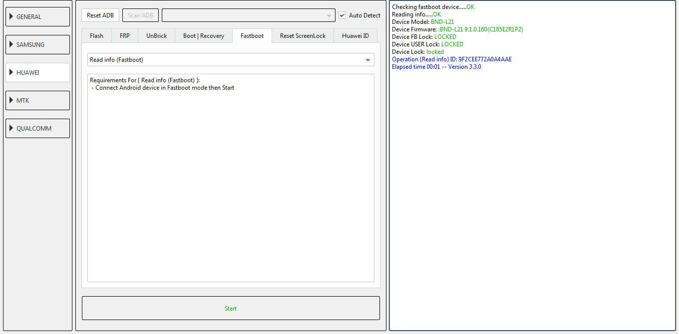

ازالة قفل FRP لهاتف Huawei Honor 7X BND-L21 بالتيست بوينت
3,931
7,673
Huawei-Honor-7X-BND-L21-Test-P
Reading info.....OK
Device Model: BND-L21
Device Firmware: :BND-L21 9.1.0.160(C185E2R1P2)
Device FB Lock: LOCKED
Device USER Lock: LOCKED
Device Lock: locked
Operation {Read info} ID: 9F2CEE772A0A4AAE
Elapsed time 00:01 -- Version 3.3.0
Waiting for USB COM 1 port.....Detected {COM210}
Connecting to device.....OK
Writing data 1.....OK
Writing data 3.....OK
Rebooting device to fastboot.....OK
Waiting for fastboot device.....OK
Reading info.....OK
Device Serial: 3RP4C17C12002779
Device IMEI: 866105034669291
Device IMEI2: 866105034694307
Device FB Lock: UNLOCKED
Device Lock: unlocked
Resetting FRP.....OK
Operation {Reset FRP [Test Point]} ID: 24533427783AEE30
Elapsed time 02:24 -- Version 3.3.0
Reading info.....OK
Device Lock: locked
Waiting for server.....OK
Reading data.....OK
Posting data to server.....OK
Waiting for server response.....OK
Unlocking device.....Security is not supported
Operation {Reset FRP using server} ID: 15313C05AD22BCAC
Elapsed time 00:22 -- Version 3.3.0

رد: ازالة قفل FRP لهاتف Huawei Honor 7X BND-L21 بالتيست بوينت
يعطيك الصحة على عرض التجربة خويا كفاح
شكرا اخي
التجربة ناجحة 10/10
